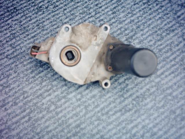

The dial when I removed the encoder motor was slanted and facing to the right " / " 4Lo so I put the truck into neutral then manually turned this dial to the Straight up " | " position which it is in Picture below:
You have to remove the front drive shaft to get to this and now that I have the motor off and I moved the transfer case back to the straight up (2Hi or Neautral) I cannot reinstall my encoder motor as the center does not align.

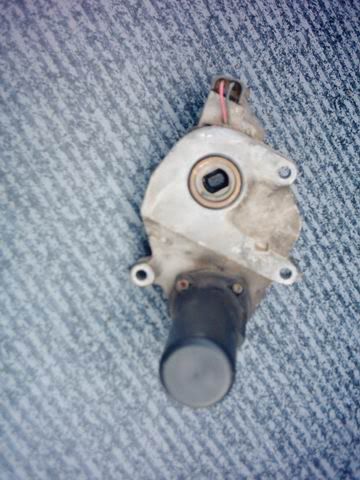

This is the positon the Encoder motor was in at 4Lo when I removed and cannot move out of
I plugged it back in underneath and started truck and put in neutral and had someone else push the 4WD dash button but nothing happened just the same click, click sound as usual you get from the Transfer Case Control Module mounted under glove box in dash and I felt a small tingle at the wire connector but not real strong and nothing in the motor unit itself.
