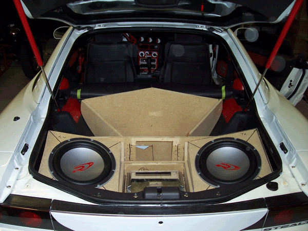

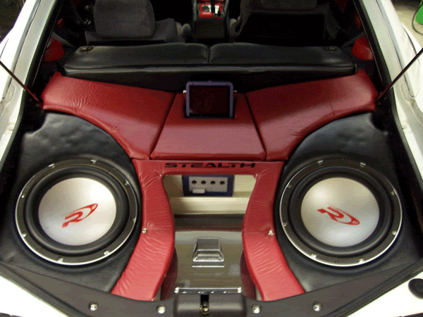

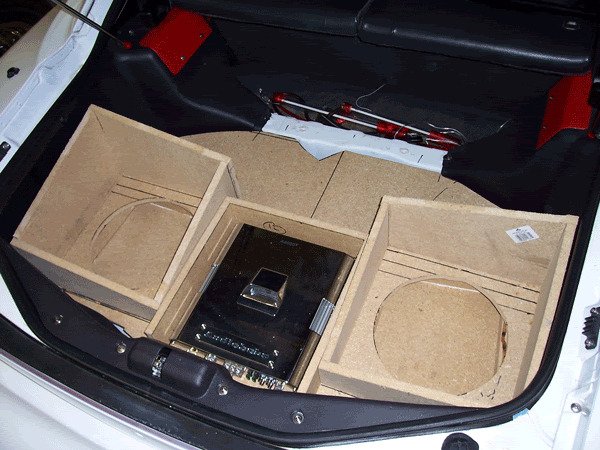

ok, i just built a custom enclosure in my car. i took out the spare tire an everything an built up in that. so once everything was done. i turned on the radio. put in one of my bass cds an the bass does not hit at all.. i mean not even close to what it used to. i can have it to the max volume.. an volume 2 before had more bass than that.. i mean literally now im wondering y. i guess my 2 problems could be wires hooked up wrong.. which im almost certain they are. and 2, there isnt enough space in the box for the sub. the specs are this.
old box: 14 x 14 x 10
my custom box: 13 x 13 x 12 on one corner, an 8 on the other. which would average to a 10?
also i had to add to the bottom of the box so its not completely square.
i did try it ported at first, then covered up the hole, an no difference. the boxes are completely sealed, so air leak isnt an issue.
but can some1 show me a diagram of exactly how the wires are supposed to be hooked up from the subs to the amp. i believe the setup now is like one + from one sub is joined with a - from the other. an then put into the positive port. then the other way as well. then on each sub there is a wire that goes from a - to a + an just stays right on the sub when i take it out.
in case ur wondering, the subs are 2 Alpine Type-R 12's (im guessing the 03 model if that makes a difference)
an i have an AudioBahn A800T amp.
i even upgraded to monster cable speaker wire for my subs.
so what do u think my problem is?
