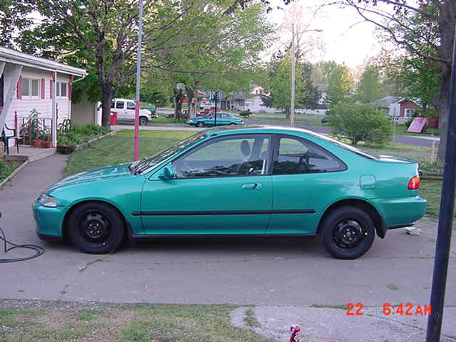

well i put my sportlines and agxs on in the front every thing went smooth. but then i went to do the back and well to broken rachets (one was craftsman) and this
well im pretty pissed i even went out and got an impact wrench and the stupid things still wouldnt budge (im talking about the bolt the holds the rear shock on) i guess ill have to take it to a shop and have it loosened. hope it doesnt cost to much. so after a full day of swet here is what my cat looks like

looks phat i love that color paint though man, very nice
be careful with that rear bolt, my socket wrench didnt break, but the bolt broke off in the arm and a used arm cost me $30

dude thats how my car was LAST WEEK!! (i too have sportlines and agx) except i had a strip strut mount.
anyways here are some suggestions
try to twist it tighter instead of looser.. that can "break the seal" for the bolt to get it moving.
also heating them up with a torch helps cuz it contracts the metal making the bolt smaller and move freely.

so should i tighten the bolt or the nut on the bolt?

either one.. the object is to have the bolt start moving and have dirt or whatever holding it come off the nut or bolt..

heat it up with a torch....... heat expands metal..... heat up the bolt, and it should expand enough to loosen it up
i say leave it how you have it..... dragster style!

Man, this problem is sooooo common on Honda/Acuras. You'll most likely have to go buy a new lower control arm.

well i tried everythind heating it up. tightening it. its not moving so looks like im going to have blow 200+ bucks getting the stupid bushing replaced. man what the heck stupid car. some shops wont even touch it. it sounds like this is really common wish i would of heard about it before i started.

It'll be cheaper going to a junkyard and getting a new LCA rather then getting the bushing replaced...
