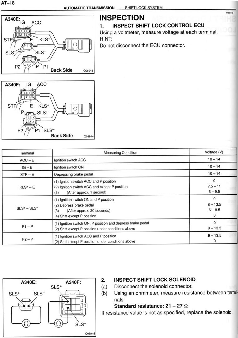

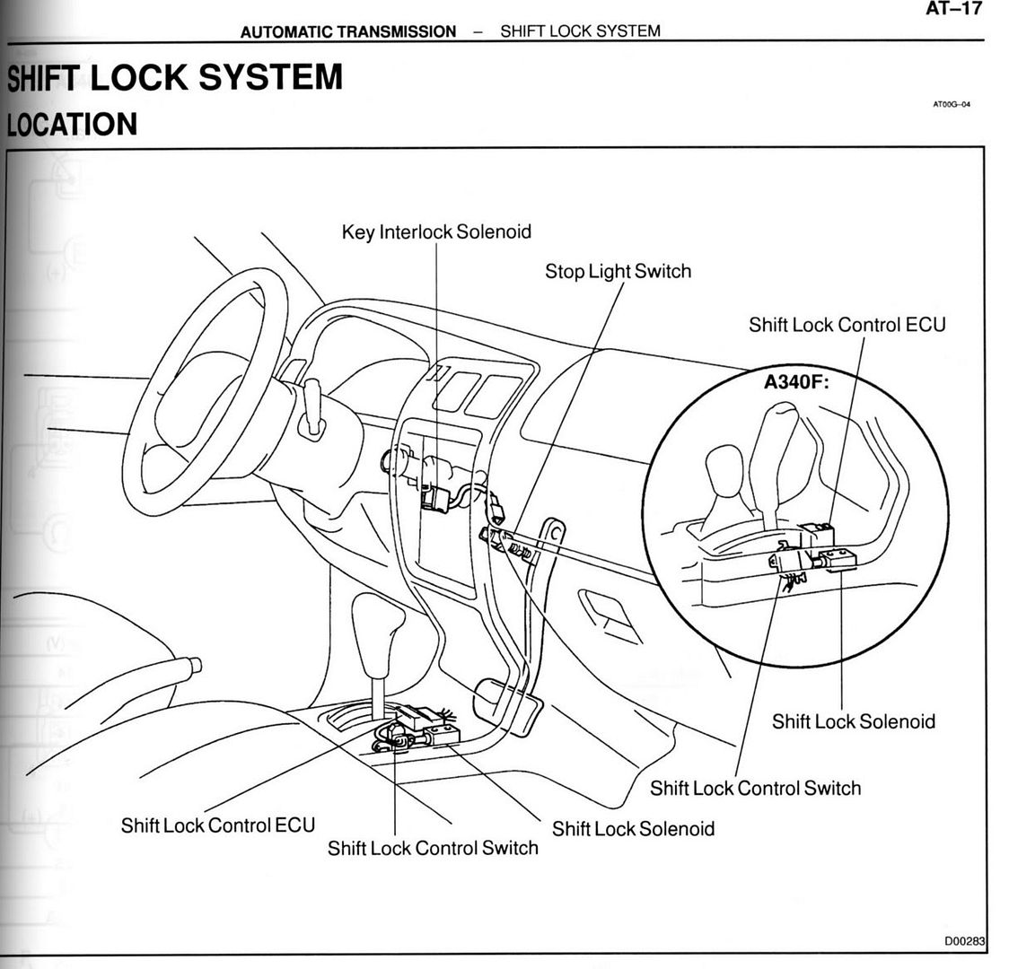

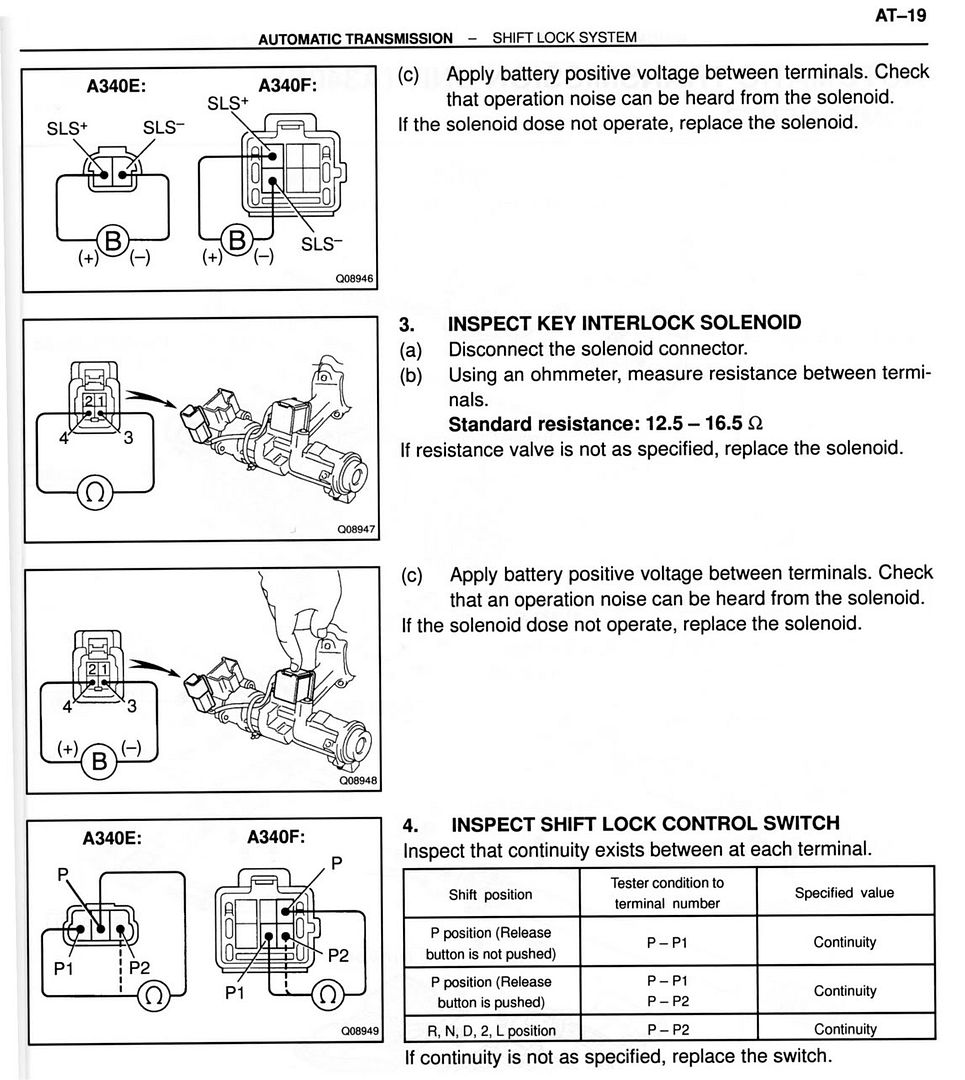

My 1997 4Runner will not move from the "park" position....even with the brake pedal depressed. The manual instructs me to push a "release switch" by the gear shifter to move it from park. That works fine, but I have to depress it each time I take the Runner out of park. Any ideas as to what would cause this?? The manual states to take it to a mech asap to have the problem diagnosed...but if I can fix it, I will...money don't grown on trees! Any input is greatly appreciated!

Test these components:

Thanks for the quick response! Looks like I've got a little work to do!!
