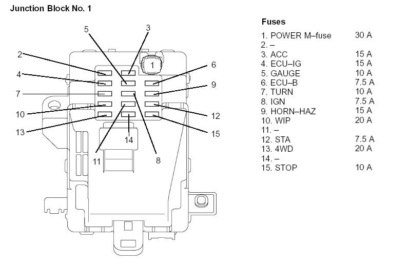

My oil pressure and water temp. gauges are not working on 1988 4Runner V6 SR5. Anyone know where the fuse is located. Thanks. Steve

The gauge fuse is under instrument panel by driver's left knee in JB1 - also fuses tach, speedometer, and fuel gauges. Not oil pressure light.
Engine Coolant Temp (ECT) gauge is probably ECT receiver gauge or sender gauge.
Oil pressure warning light/gauge may be bulb/gauge mechanism or pressure switch.
Of course either could be a wiring problem
