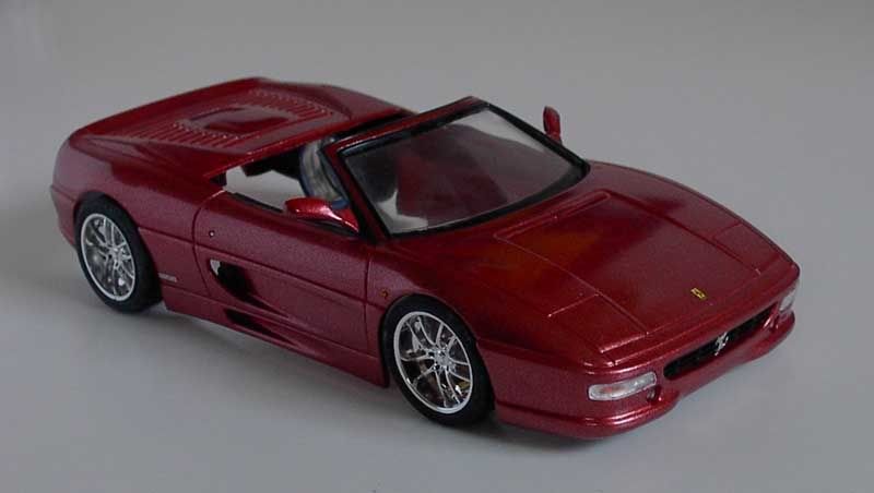

Duplicolor red metallic =>
Duplicolor works perfect. This was my first try. I didn't have any problems with the nozzle and did two mist coats and after that two wet coats. No orange peel at all and I didn't even use clear coat. Here in The Netherlands I pay the same as for a Tamiya bottle only the Duplicolor bottle contents 4 times more paint then the Tamiya one. It really is pretty cheap. I'll be using it a lot more in the future.
