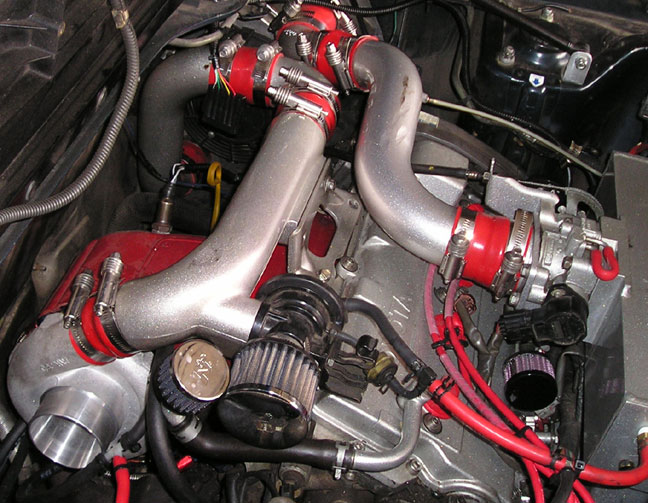

Well Hyde's winter engine work has come to an end.

Over the past 3 months all of this was added to Hyde:
Hydra Nemesis EMS with wideband O2 and launch control
ATS Adjustable Cam gears
HKS 272 intake cam & HKS 264 Exhaust cam
Wolfkatz Fuel Rail
GT35r BB turbo:
Blitz 850 CC injectors
New Spec Stage 3 pressure plate and Stage 5 Disc (Thanks Mister3!)
Resurfaced OEM flywheel
Kirkasaurus front and back motor mount inserts
And of course, NoShoes tuning.
We finished dyno tuning an hour ago and although the results are wonderful, Hyde's tendency to overheat seems to be increasing in frequency. For those of you that do not know, I have been having intermittent overheating issues with Hyde since Novemebr of 2003 when I ran my first 11 sec pass. I actually did that run while overheating with the low oil light on
All I am going to say, is keep your ignition compenents fresh.
This is the FIRST winter that I did not buy new Toyota wires ... didn't bother since I had less than 5000 miles on last years set. 5000 hard miles of a failing MSD ignition box firing at them .... lesson learned. Hyde is now on a 100% stock ignition.
The Blitz DSBC has 4 options to dial in boost. We set them up and tuned them at: 12 psi (291 rwhp), 15 psi (323 rwhp), 17 psi (354 rwhp) and 20 psi (377 rwhp).

nice work Jeff.... REALLY glad to see Hyde up and running again!
kinda surprised the power's pretty close down low even with the bigger turbo!
ok so on the air fuel graph down the bottom, whats the blue line round 18:1 maxed out?

TRD2000, I believe the extra blue line is just a glitch in the Matrix. Have you experienced dejaveu? (sp)
As for power down low, NoShoes (my tuner) adjusted the 272/264 cam gears in order to assist low end response. We gave up a bit up top, but with the hill climbs, I need to keep the low end spool. I never go below 4300 rpms when racing and you may note that is exactly where the graphs cross I assure you that was not happenstance luck ~ it was planned that way.
