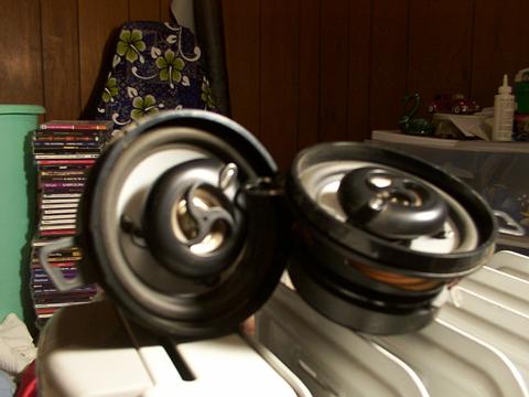

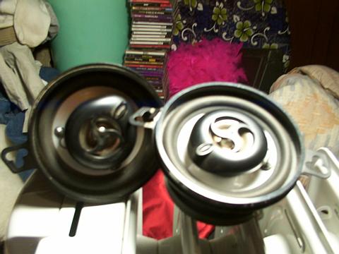

Alright, a friend of mine got these speakers and then didn't want them. They're 3.5"two-way Blaupunkt Overdrives. I was wondering what you guys think of them. I don't really like Blaupunky too much, but he paid $55 for them, and I got them for $15 so I couldn't pass that up. Oh yeah, and they've never been used.
Specs: 90 watts max/30 rms
Frequency response: 80-20,000 Hz
Sensitivity:92dB (2.83V-1m)/89 dB (1W/1m)
4 ohm
5.3 oz magnet
Thiele/Small parameters: fs = 134 Hz Qts = 1.53 Vas = 0.05 cu. ft
Extended Pole Design

i tend to not like those type of two or three way speakers. good price though!! also watch out!! radiators give off heat and hope u didn't leave them on their when it was hot. hope you also didn't smack them on their (heating and hitting a magnet makes them lose their magnetivity)

they are actually pretty decent. $15 is a good price. i think they'll sound nice in my mom's van
Yeah, I made sure it wasn't hot and I'm gentle with them. What don't you like about that kind of two-way speakers?

not only does the tweets block the sound from the woofer... the woofer cannot be fully enclosed (in order to mount that tweeter, there is a hole in the woofer for it) therefore a week midbass IMO.
but do not ignore the fact they were 15 bucks!
