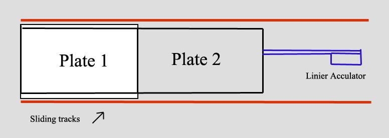

Here is the best system that I'v found of doing it on a car. The area that is shaded is covered behind the bumper. You use a linier acculator to slide them back and forth with limit sensors that stop it at the right spots. The tracts are made out of drawer rollers and are available at any hardware store. I make the backing plate that the plates accually mount to out of fiberglass because I have lots of it laying around but you could use sheet metal, wood, pretty much anything. Most acculators will come with everything needed to wire them, or atleast instructions.
With fliping it you got to worry about clearance issues with the plate accually rotaiting, and also how to make it stop at the certain point, both of witch are overcomeable with a little planning.

Yeah, a linear actuator sounds like a good idea aswell. I'm starting to seriousally consider the legality of this. I wonder if it's only illegal if i use it while i'm driving... Like you said, if it's used only for show purposes, then I don't see why there should be a problem.

Can your hinged one be operated from within the car? If you've got room in the bumper, sliding makes a whole lot more sense. Much simpler.

anyway, TSC's idea would be best, flipping it wouldnt be TOO hard, but just using a linear actuator would be easier and more efficent.... but how to make it look stock...hmmmm....
