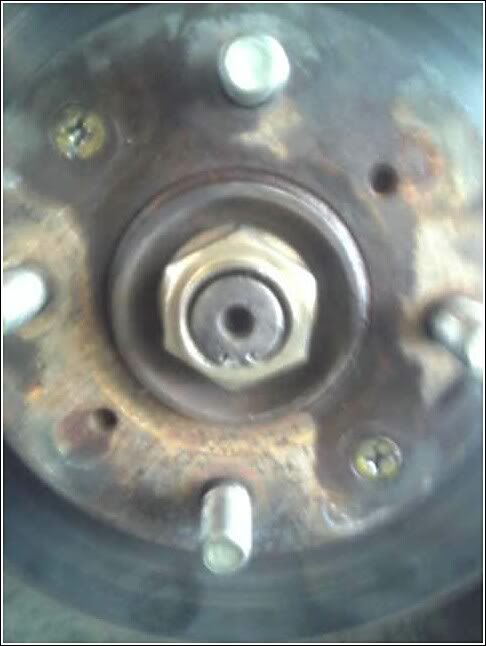

Proper Maintance is probally something I shoud learn. The pads I had bought didn't actually come with any lube, so do you have any suggestions as to what lube I should use? Of course it would appear that my calipers had seized and the rotor was locked up as the hub tried to turn and busted my rotor.
With the hub still on I was able to move the rotor up and down. It looks as if the rotor busted off the hub. Here are some pictures I have of it right now. Also anyone have any clue how to get the axel retaining nut off? I sat there with a breaker bar but that bitch didn't want to come off. Of course that may be because the nut has been notched on, but I can't get that bitch out.
Thanks to technology I have these pictures if they can help any...

If your trying to change the rotor there is no reason to remove the axle nut. Simply remove the 2 phillips head screws on the rotor and it will come off. Getting the screws out isn't so simple, an impact driver should be used. You hit the impact driver with a hammer to remove/install screws. Possibly a parts store may loan you one.
I beleive that link I left before shows how to change a rotor. http://importnut.net/brakes.htm
To remove the axle nut your best off using impact gun. The other way is to remove the wheel cover or center cap, re-install wheel, set car on tires, use a large breaker bar through the hole in the wheel.

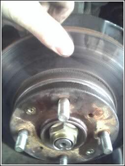

Ok all done, yea I feel like an idiot trying to bust off the axel retaining nut, when it was just two screws . My dad actually had a socket that held a screw driver head and we busted it off that way. When I bought pads, I was kindy weary of the shims, as they were held there in place by a adhesive... Well appeartnly the shims adhesive sucked worse then my mechanical ability, and had caused the pads to slip. And on the drivers side I had been grinding the shim into the side of the rotor and resulted in this thise lovely looking rotor
So needless to say I went and picked up a set of rotors from Autozone, got the bitches turned, and got new pads for free from Checker. Shoulda made them pay for the rotors but to late for that....

That's hard to beleive that a flimsy shim did that to a rotor.
Old 03-19-2005, 09:25 AM
Scott82 Scott82 is offline
Join Date: Feb 2005
Posts: 597
Re: Brakes broke...
i agree, something elso did that, that shim would have melted away from heat or just simply bent itself out of the way. Something pretty solid had to do that cause it takes quiet a bit of heat and pressure in that case to cut thru steel unless those rotor are pressed together for somereason but they should be one solid piece.
