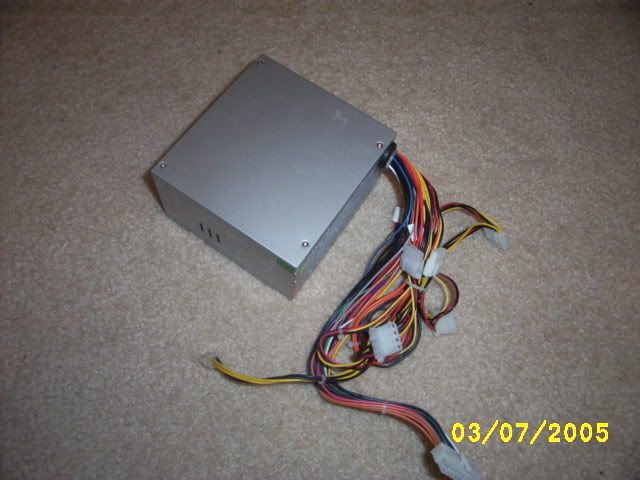

The First thing you will need will be a PSU. They look a little something like this.

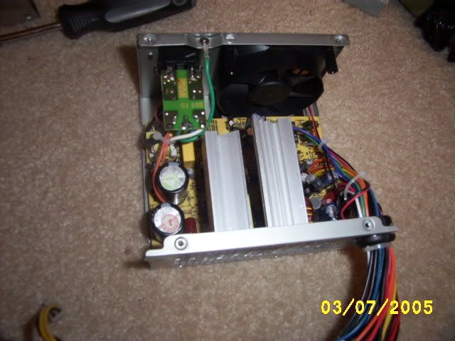

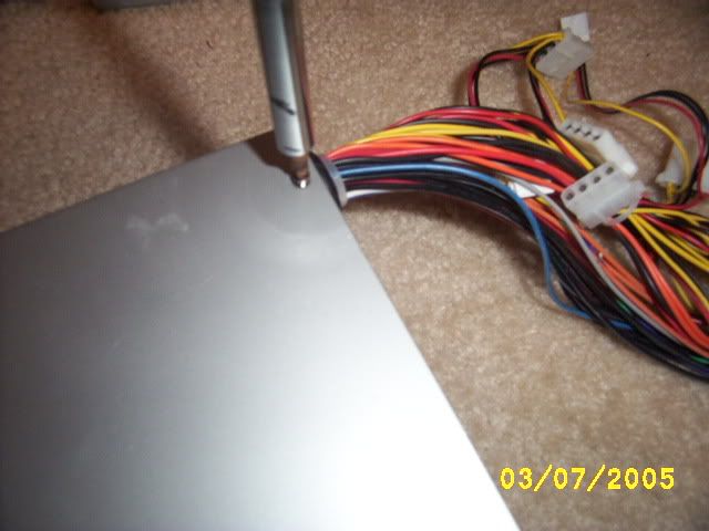

What you are going to do is take the case off. Yes this means breaking the "Do Not Remove, Removal Voids Warranty" stickers.
Examine the inside. Fine the Capacitors. Stear clear of the caps, caps store charge and if some how you actualy managed to short out the terminals you are in for a pretty big shock.

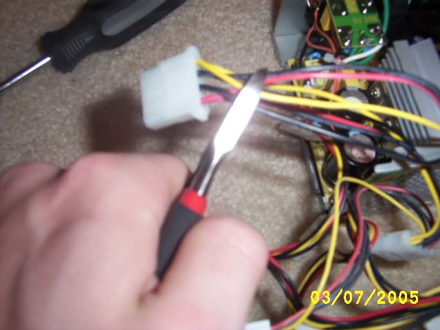

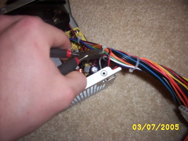

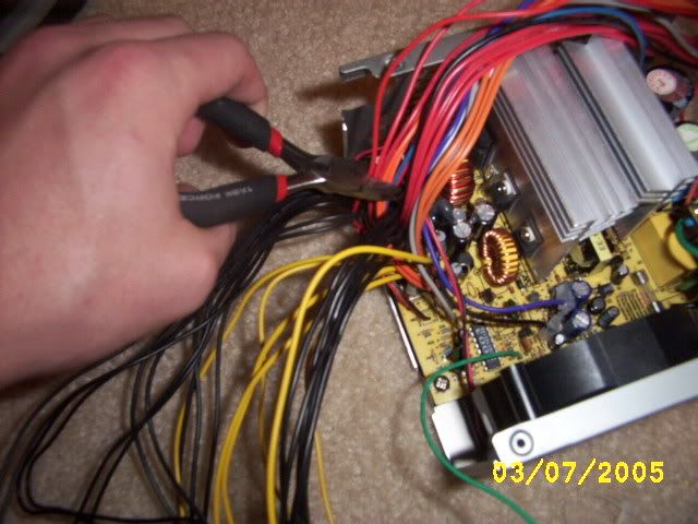

Start Clipping wires, but dont just go at it like crazy man with a lawn mower. Cut as close as porible to the plugs. the longer the wires the better. The wires you remove may come as some use later on in life. Any true audio guy has at least $100 worth of copper in all of the spare wire in his house.

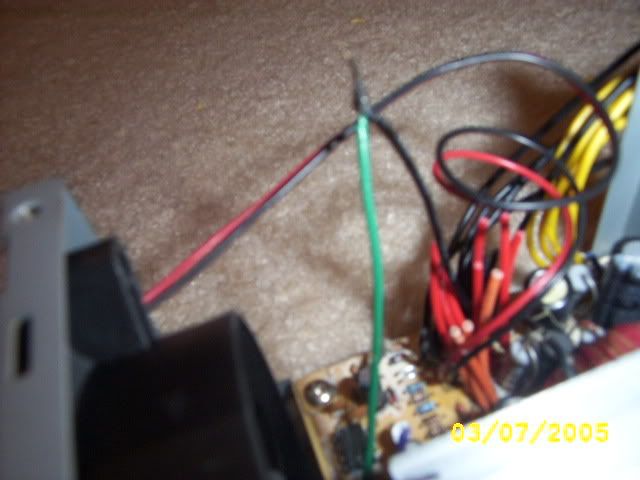

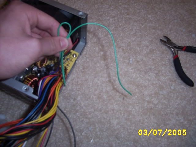

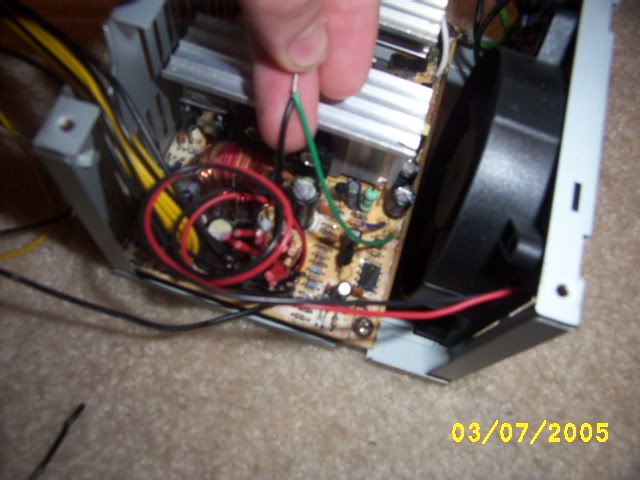

Locate the Green remote power on wire. There should be only one green wire so it is kind of hard to screw up.
Time for a little hair cut. trim all wires EXCEPT for the Yellow (12v +), black (Ground), and Green (rem. on). This means cut the Red, Orange, Blue, Purple, or any other color. Note: This is just the common color code. check to make sure this code follows suit with your PSU. also, dont cut the leads to the fan. there will be a black and red lead going to the fan. you want your PSU to stay cool.

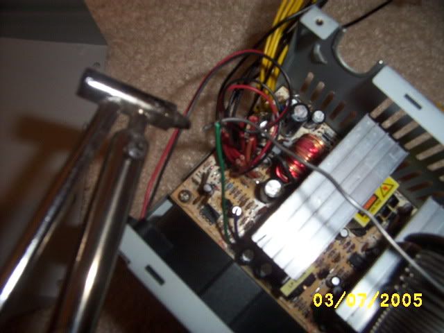

Take the green wire and a (one, not all) black (ground) wire and cut them to similar lengths so that they will still be able to youch at the ends with slack.

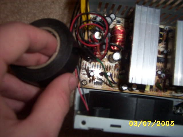

Now twist them togather and solder. then cover with either heat shrink or electrical tape.

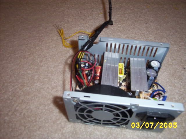

Finished product before Electrical tape
Finished

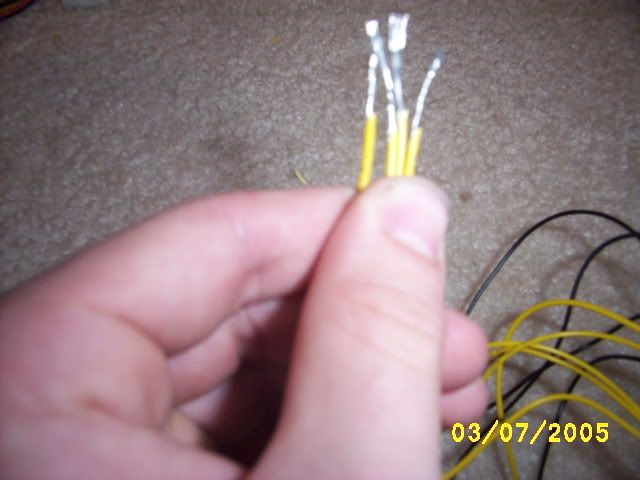

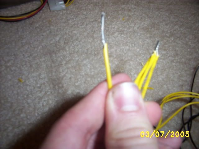

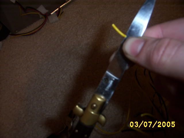

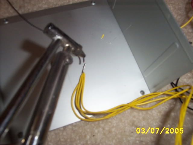

Now strip all of the yellow (should be at least 5) and an equal number of black as yellow about 1/2". any remaining blacks can be trimmed. I used a knife because I suck at striping with plyers and I hate using wire stripers.
Now take all but one of the yellows and all of the blacks and twist them togather and solder. as in 4 yellows togather and 5 blacks togather and then twist and tint one yellow by itsself (for amp remote turn on)

Close it back up tucking the green wired that is conected to the black wire inside the case. and of course leaving the black and yellow's out of the case so they can be hooked up to your amp.

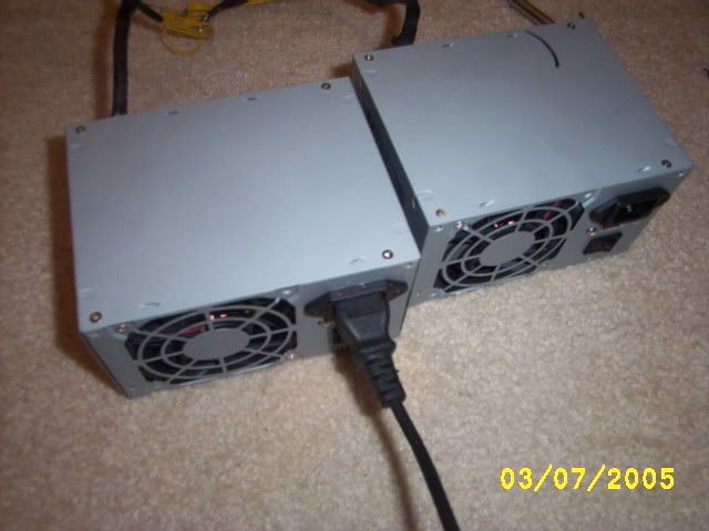

Congrats, you have now just created your own 12v power supply. You may have noticed i have two. well that is beause my amp can handle 40a and sine one can only provide 25 peak i am using two in parallel to get 50a peak. Eventually I will add to this using 4 3.3v in series and 3 5v in series to see which gives best results.
