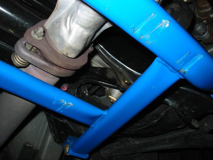

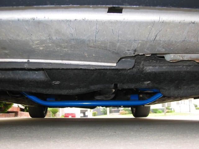

H-brace without a doubt. I have one on my EJ6 Civic, and it made a world of differance. Instead of just tying the lower subframe points like a typical lower tiebar does, it ties those 2 points ALONG with 2 additional points on the actual chassis of the car.
As for clearance, an H-brace actually decreases clearance since I never have seen a lower tiebar that hangs as low as an H-brace. Mine hangs pretty low as you can see here, but so does anyone's that has an H-brace (my Civic is at about a "2 drop). I've never had an issue with the clearance yet though, except on 2 occasions, and those were my own fault. One time was on a local mountain road, I tried straddling over a rock that was kinda tall (about "5-"6 I'd say) and I misjudged how tall it really was. Cleared my CTR front lip, but hit the hell outta the H-brace putting a dent in it, but that was it. Sure jarred the chassis and the car real good though. Over all especially for it's price, it's one of the better investments I've made for my car as far as handling goes.
