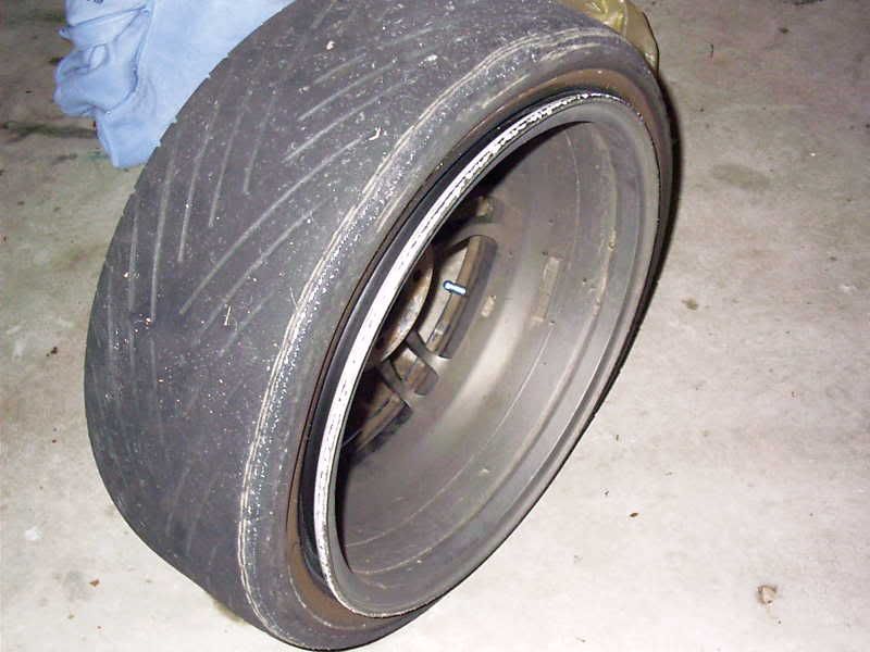

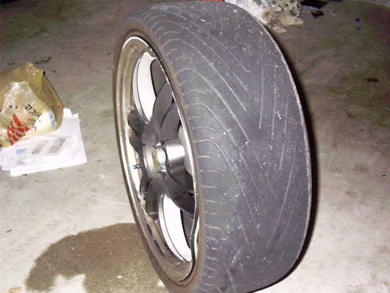

both of my front tires or worn on the inside, i know that lowering your car causes negative camber but mine isnt lowered, so my question is could i still have some negative camber without lowering my car... what could cause this besides the camber?

Not rotating your tires will cause them to wear on the inside on the front. Also if your stock springs or struts are worn and not up to the job anymore it can cause that as well. Did you rotate them often?

yes i rotated them often, so you think my suspension os worn out? well if thats the case time to replace it with what iwant... COILOVERSS lol, thanks for the helf and if anyone else has any other ideas please let me know.. thanks

Actually you have one rim that is bent really bad, have you hit something like that before? Also when was your last alignment?

also if u'r wheels r towed out, that'll cause the insides of the tires to wear.
i agree w/ whtteg wutever u hit to get the wheel that bent, prolly messed the alignment up.
thro u'r stocks back on and take it to the shop for an alignment, either u'r camber or u'r tow is off. either way i'd get it checked out.

yeah i know my rim is bent up pretty bad.. dont know what to do about it, my fault and my own stupidity i was follwing my freind pretty fast and we came to a bridge and it wasnt even with the road and i hit it pretty hard... is there somewhere that will repair stuff like that?

Look in your local phone book in the yellow pages under wheel reapair. I know there are a few around here in Atlanta. I have never had to get a wheel repaired so you might find it cheaper to by another, not sure though. But either way please keep everybody posted about the wheel repair so that others will know too.

yeah my bro dented his wheel too, kinda same deal. they ripped up the roads and exposed a 4" deep pothole (no joke he took pics as proof) and he hit it before we knew it was there. needless to say, he reported it to the city, and they said since he had proof, that they'd pay for the repairs. I found a place like 3 min from my house that right on their sign says they fix wheels. he has yet to call on a price though. if he gets to it, or i do for him, then i'll get back w/ a rough price for ya. his isn't dented as bad, but his is on both inside and outside of the rim, and very slight on the inside of the back rim on the same side
regardless, the denting of a rim shouldn't cause the tire to wear like that. it is still gonna be linked to camber or toe.
