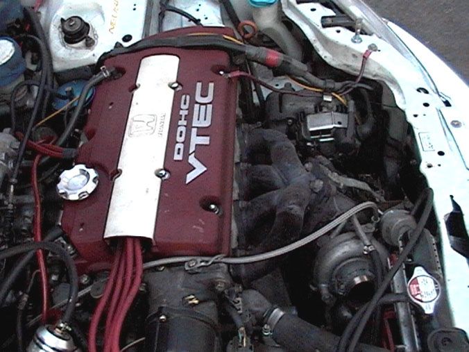

With just an h22a swap you'll be running 14's, possibly high 13's if you get really good at driving it. Honestly I don't know who makes a turbo kit for that motor and that car, I'm sure someone does. But there is not a lot of room in the engine bay for the turbo and h22. Not that it can't be done, but it's going to be a pain with clearance. Mostly it's from the turbo being so close to the radiator fan. But if your going turbo, I'd personally recommend not getthing the h22, and just sticking with an LS or GS-R motor. OBD2 and OBD1 are different emission controls. OBD1 is '92-'95 (also '96 with the JDM H22a for some reason), and OBD2a is '96-'98. Basically there is slightly different wiring done on the injectors, distributor, alternator, an extra O2 sensor, and different plugs on the ECU (there's probably more I'm forgetting). But you could just buy a OBD2a to OBD1 conversion harness. It will plug into the plugs on the harness that leads to the ECU, and have the plugs for the OBD1 ECU on the other side. It's basically just an adapter so you don't have to change plugs and do the wiring yourself. Here's a link to one, the cheapest I've seen: http://www.boomslang.us/obd2.htm

there is tons of room for a turbo kit in the engine bay. me and my friend did this swap in his 95 hatch.im not sure what is different in a 96 hatch but the only cutting we did was for the shift cables and passenger side mount bracket had to be cut a little.

Re: Need some opinions, please. (H22A instead of B18C, '96 hatch)
There's definently not a ton of room, maybe it just all depends on what manifold you're using. My buddy got one from South Florida Performance, and there was just enough room for it. I mean there is quite a bit of room between the manifold and front part of the frame, but there was only an inch or so between the turbo and the radiator fan. This is on a '95 LX too. But yes the only cutting is for the shifter and the passenger mount, like I stated previously. It's the same between the 5th gens and 6th gens in that regards. I think the 4th gen is the only one you need to do more cutting on, but I've only read that so who knows with all the BS spread around with the h22a civc swap in general.
EDIT - here's a pic of the clearance of the turbo and the frame: http://img.photobucket.com/albums/v4.../clearance.jpg
