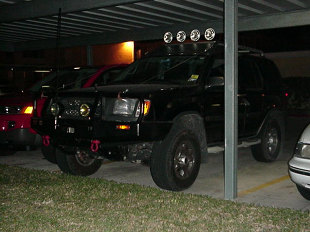

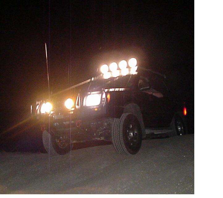

opinions welcome this was only to test my lights and also a pic on the parking lot i know it sucks but i just got my camera and since then i have not being offroading. let me know what you think..:smoker2: .

You have plenty of off road lights! But the other pics are too dark! Looks like a black X?

Lose the steprails and the street tires. Good to see you got the uploading working.

working on the tires probably in two weeks or so and ill probably lose the step rails pretty quick, i have been thinking about it for a while now. Thanks

Classic... CB antenna bolted to the fairlead mount, ARB mounted with only 4 bolts, tree wires, rattling shackles, street tires and step rails...

Pretty good eyes Ian. I would not have picked only 4 bolts on the ARB.

Yeah, that could be a problem. If I remember right those bolts are in the two slotted parts of the ARB, so the bumper could shift under impact.

With all those lights was the Alternator constantly on?
What was the idle RPM?
Show us some good offroad pics next time to make up for the driveway shots here.

I am not running a lift just cranked torsion bars and i live in Corpus Christi Texas but i am originally from Venezuela, and i have not have the time to fix the arb in order to put the other two screws. Thanks for the comments

Loosen the front and rear bolts you already have installed, so the bar can move freely. Have someone grab the front bar by the top tube and lift it until you can insert the foremost bolts in the bottom slot. Next have the person pull the top tube towards the front of the vehicle. This should pivot the back slot upwards. If it's still not moving you can put a floor jack under the back edge by the bolt hole and use the jack to help lift into place. This should help even up the side wings with the body lines. Not every frame is the same, so sometimes you just can't get the side wings aligned, but pulling forward on the bar, and using a floor jack should get the rear slot in the best position possible to tighten everything down.
This method has helped people get their bars installed without additional drilling of the bolt slots. Hope that helps.
