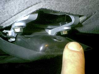

The sunroof just needs to be adjusted. Open the sunroof and you should see a screw in the middle of the black plastic shroud. Remove the screw, pull the shroud down, and there are a couple of bolts. Loosen them up and if you slide them back it will tighten the handle. You'll need to fiddle with it a bit to get the adjustment right - all the way back was way too tight on mine. Here's a pic
