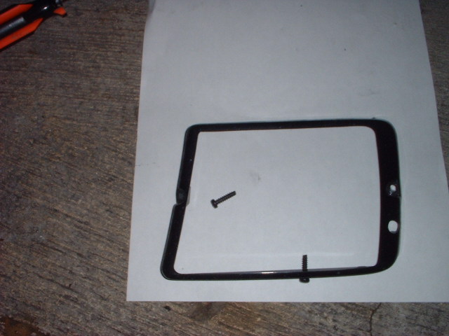

I got the first part easy .. these are your directions there on the ground

Yeah, that black screw in the picture does not need to be removed. You got the black plastic first part out so all that left is just 4 silver screws in each corner of the foglight fixture. After they're out, the fixture should come out easy. Let me know if you finish.
Since you moved the foglight adjustment screw, you will need to readjust it once you have the new bulb in and everthing put back. Not hard either and you can do it with everything in place.

What i did wrong last nght was work in the dark. There were two other screws on the right side that I could not seee becuase the housing was black and so were the screws ..
They are recessed kinda of far back ... I suggest using a magnetic screw driver or you will lose the screws ......
