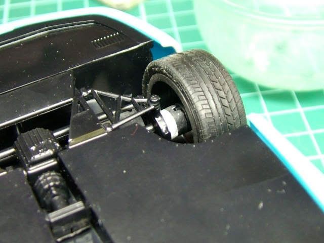

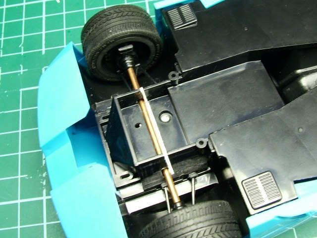

First here is the back end where the rear wheels have been moved back and lowered. I kinda knew about this problem from Veyron and Kunta’s build diaries. But I didn’t realise how narrow the front track was as well. Pretty easy to fix, but took 2.5mm of plastic card on either side to bring the front wheels out wide enough.
The result is probably a bit too low bit hopefully will be okay when everything is assembled and painted. Even though I stretched the wheelbase, the front wheels didn’t sit centrally in the arches so I added some bulk to the front part. You can see the white card just in front of the wheels. The rims are only black because I’ve stripped the chrome off, they will be silver plated later.

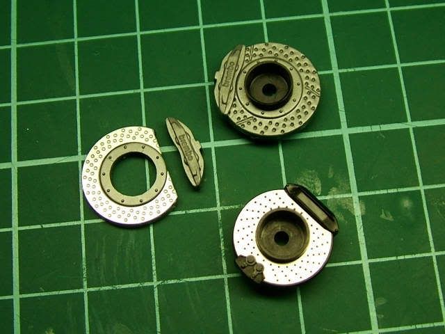

Brakes also need a bit of work. The rears aren’t too bad, especially when the PE form Acustion’s set is added. The fronts are way too small to my eye. So I’m replacing them with some larger disks from a Megane, and PE from a S27 Jag XJR-9LM set. The calliper has been separated so the PE face can fit properly. I will probably replace the callipers on the rear too, since the new ones look a bit closer to reality. I also screwed up, because the 40th anniversary kit doesn’t include the white Lamborghini script for the callipers, just black ones. So might have to do something weird with the calliper colour, like paint it green to match the body! What do you guys reckon?

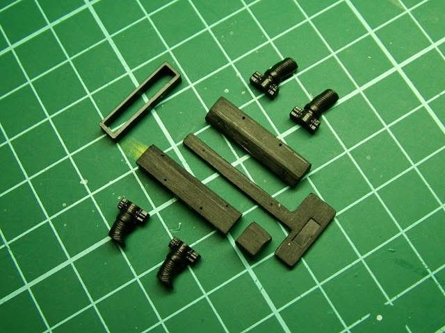

The kits engine detail is very spartan, I contemplated building it curbside. However, the Acustion PE set features some Lamborghini scripts for the induction boxes that will look pretty cool, so will have a go at jazzing it up. Here I’ve split up the single piece for the top of the engine so I can modify, paint and decal it. The heads, exhaust and ancillaries will need major work as Fujimi provide zero detail OOB.

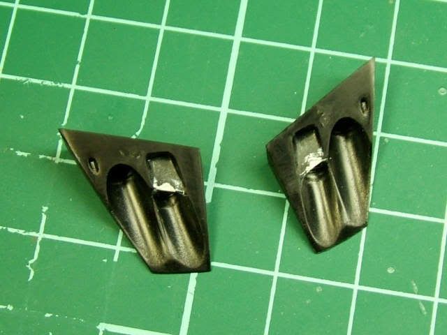

Also lots of little things like the headlight have been very poorly done. Here I'm in the process of trying to correct the shape with some tiny pieces of plastic card. Also check out the rough mouldings, looks like the master was covered in sand or something

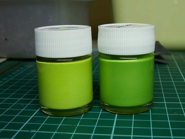

Finally, here is the colour it is going to be. PPG Verde Ithaca, pearlescent metallic flue green. It comes in two coats, an almost fluorescent lime green base followed by the pearl. It finishes matt and needs a clear coat to give a shine. It's mixed from the actual paint codes from the real car. The pearl is very fine so I’m hoping it will look okay in scale.
