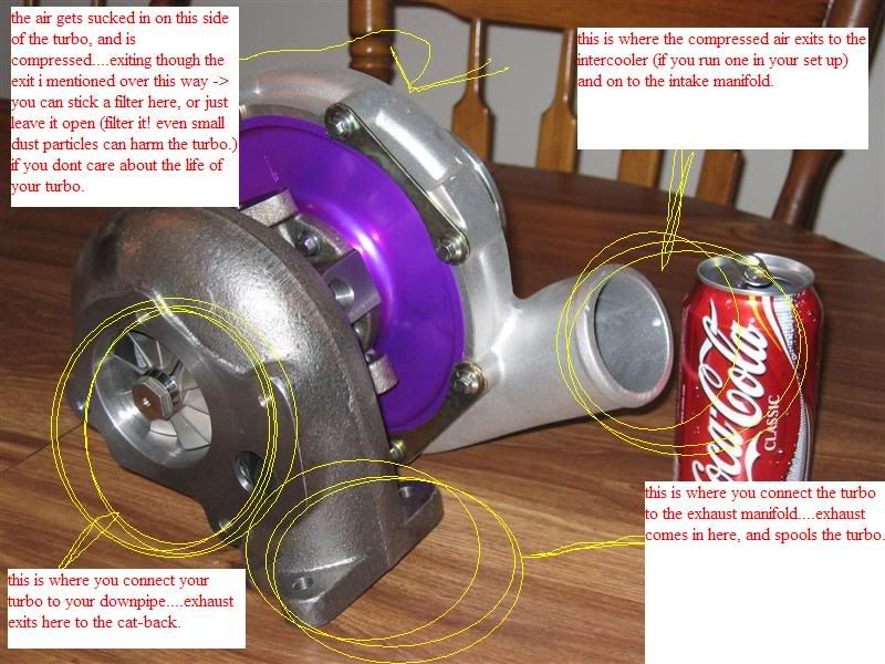

Old 11-17-2004, 01:15 AM
nismo_power's Avatar
nismo_power nismo_power is offline
Join Date: Oct 2004
Posts: 855
Re: How to: Turbocharge your motor
SORRY TO BRING UP AN OLD POST
i was looking at this....and thought there was something wrong with the set up. and i found it. you got your parts of the turbo ALL WRONG. i see the last post is in september...but i figured it would be better to bring up an old post and fix a mistake, than let people build their set ups wrong. i mean...we are about detail right?
Then once you have your intake piping off the turbo dry
attach your exhaust dump piping, and send it back to the headers
i also answered that statement with the picture. the exhaust dump does not go back to the exhaust manifold. the downpipe connects directly to the turbo.
Old 11-22-2004, 07:00 PM
ElRxBandito's Avatar
ElRxBandito ElRxBandito is offline
Join Date: Aug 2004
Posts: 959
Yeah, I found that out not too long ago also, so I redid all my turbo systems, and I'm working on a better tutorial. Sorry about the mistake, and thanks for catching that.
I'm back!
Old 11-23-2004, 01:19 AM
Join Date: Oct 2004
Posts: 855
no prob i didnt know if you caught that or were just a bit confused . im here to help .
