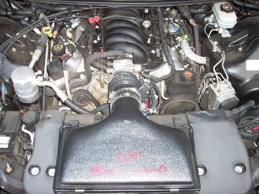

Hello. I recently bought an awesome 1999 Z28. I will post a pic of it so it can be my new sig once I wash the car. It has all, and I mean all, the factory options, including the rare sports appearance package. (I heard it was rare on Z28's)

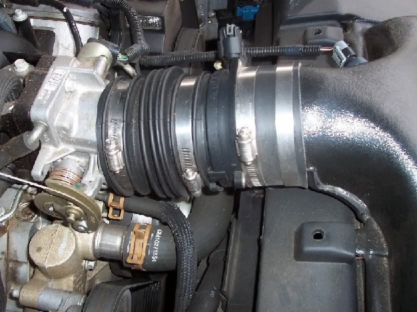

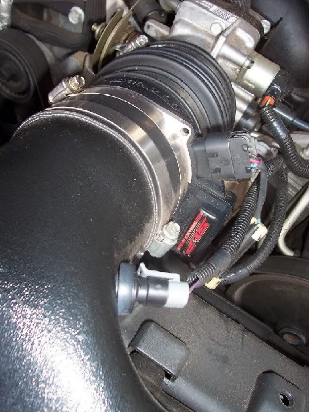

Anyway, when I bought the car, it had some mods done to it. All the dealer could tell me was that it was a new intake. I have no idea what it is. What mods do I have, and how much power do they give me? I know that I at least have a new airbox and I think an SLP oxygen sensor. Can you guys tell me exactly what I have?

Your new "lid" (The LS1 Motorsports piece) is worth perhaps 5-10 HP

looks like you have a wisper lid-which just eliminates the factory silencers on either side of the factory airbox, and also it looks like a new mass air flow sensor which i dont know how much its worth i have an lt1, you need to run some 4" a/c tubes from the scoops on your front bumper through the frame and up into the bottom of your airbox, that will give you about 60 hp at 100mph

I don't think that the intakes on the 99's were composite (cool word for plastic). I think you have the intake that came stock on 01's and 02's.

you have an aftermarket (LS1Motorsports/Quartermileperformance) Lid, and an SLP MAF. the MAF may have done more harm than good on the stock car. the Intake is stock, ALL ls1's had the composite/polymer intake, but the one on your car is a LS1 intake and the 2001+ had an LS6 intake that did not have EGR on the top (although I have seen some LS6 intakes that were made to have the EGR provisions).
