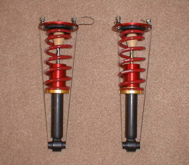

New P10 Custom Coilovers
Here are some pictures of my new custom coilover setup from ShigSpeed. Not sure if this works

These utilizes all new Ground Control ERS springs (you choose rate) and hardware, KONI yellow inserts (top double adjustable front and rear), custom shock/strut housing, new rear top mounts, polycell bumpstops, upper top hat, urethane bushings, nuts, washers. The rears come unassembled but easy to put together. Contact Scott at [email protected] for more informtion.

Fronts

Rear Set

Those look NICE! Is this a similar setup to what David K. is running on his G? I still have my stock suspension sitting in my parents garage too :-D Also, those look like stock rear mounts, they weren't modified at all to give more travel were they? Not that we really need it, I'm just curious.. Oh yeah, what spring rate did you go with? Thanks!

Justin,
Yes they are almost similar to David K's.. Those are the stock rear mounts and were not modified at all. I went with 340f/250r spring rates.

Just to clarify, I meant that both the front and rears are adjustable. Not that each one are double adjustable . It's actually only single adjustable in rebound. Sorry for the mix up.

No problem, I know the double adjustable Konis have an adjuster at both the top and the bottom, not just the top.
