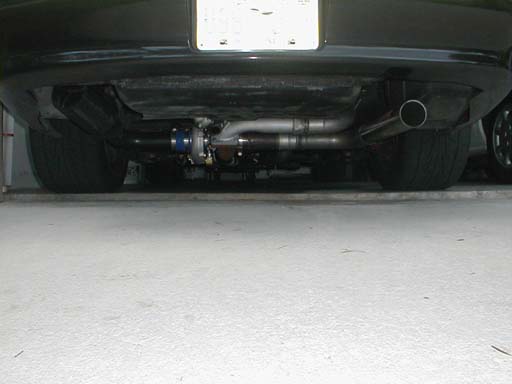

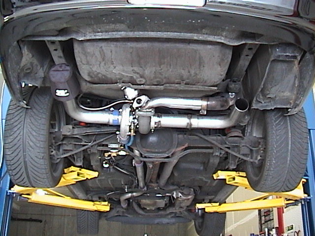

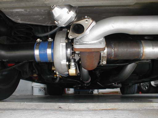

No room for a turbo??
THIS SETUP WAS DONE ON A CAMARO.
I don't know if you guys have seen these pictures, but it seems like an interesting setup to me. Can someone list the pros/cons? Besides the fact that a turbo is quite the expensive skid plate.... .

What if it floods, and your driving through all that. Also what if your car bottom'd out, it would do some serious damage. Not to mention having the turbo way back there, you will have some bad lag from the turbo. Does it even get that much air flow in that spot?

the efficiency of that setup must be extremelly bad...the gasses are way to slow and cold back there(compared to the when they exit)...and as omicron said the lag should be huge

Also, imagine hitting a puddle of cold water. The turbo's impeller spins at 100,000 plus RPMs. You can imagine they get pretty hot. That nice cold water will crack that turbo housing like glass.
That is a horrible placement for a turbo. I would never put one there.

ok i get what you are saying but even then if a guy looks under the hood he would have to be a moron not to notice something wrong....
first there would be too much piping and the intake would not be visible (this asuming there is no intercooler) an inter would give you away pretty fast....
and that car without an intercooler would not be able to push enough psi to be a real monster.....so couple only a few psi + very ineficient turbo + v6 camaro = a not very fast car
sorry for my skepticism but this is how i see the setup.....and polygon is right hit a pudle of water and the turbo will crack in a sec (thanks for pointing that out poly I completelly missed it)

Have seen those pictures before, that setup is worthless. A turbocharger needs hot gases and exhaust pulses to the turbine, this will not be the case here. It will also take very long to pressurise the exhaust as well as the intake. This is a good example how not to do. There are however good setups which have had the turbo under the car, but then it was placed close to the engine.
Water will not cause the turbo to crack, water has always been used for cooling in the steel industry.
