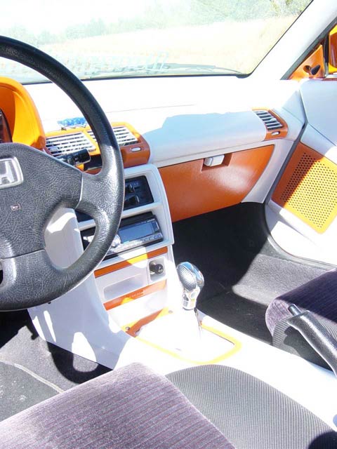

Krylon Fusion kicks ass.
I used 13 can of it on my interior.

90civicrider what's up with the ghetto black stock steering wheel? All that work & your dreamsicle theme is ruined.
