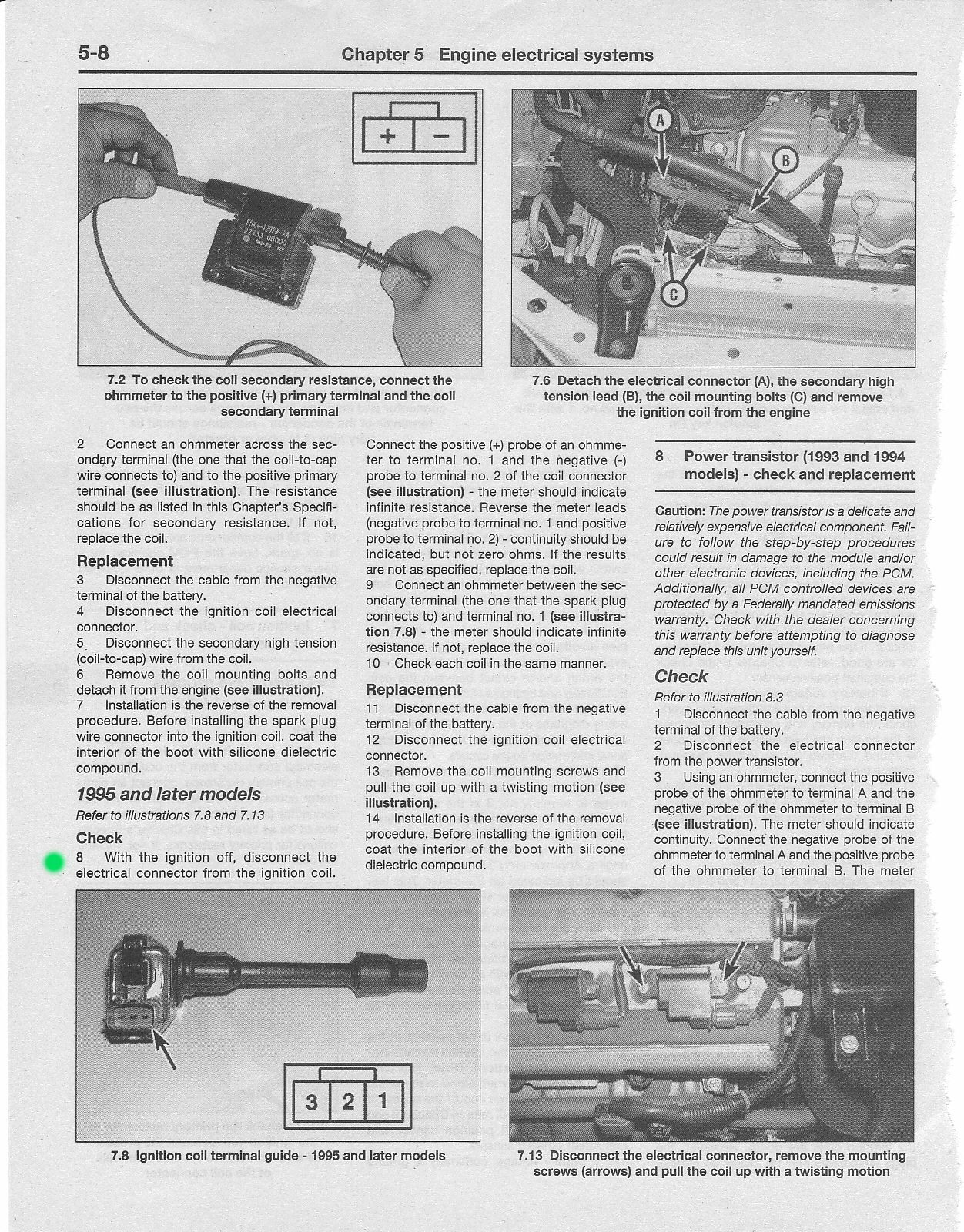

It seems everyone has this problem. To diagnose which coilpack is bad, you will need a multimeter.
Here is a scan of the page on how to check them.
http://lordrashmi.com/pics/coilpack.jpg
Hope this helps. I had the exact same problem you did.
