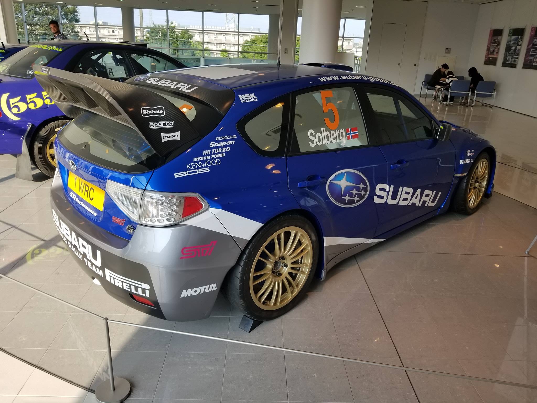

This is the ModellingMaster resin kit built out of the box with a few extras. It's closest to the presentation car in the STI Museum. Paint is Zero Paints World Rally Blue - Subaru 02C (2001-2006/BRZ). Seatbelts are from Eduard.
