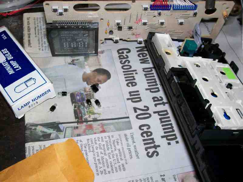

All but one of my control heads now function just fine except for having burnt-out "night lights" to illuminate the buttons when the headlights are on. There are three unbelievably tiny light-bulbs in the control head that need to be replaced; and I haven't found a source for them yet.

The two circuit boards pull apart via long contact pins. Two of the three round, black 1/4-turn sockets for the "night lights" are visible in this photo. Light bulbs themselves are about the size of a big whitehead zit.
Has anyone tried Neo Wedge bulbs? I bought the size T5/T4.7 bulbs but they turned out not to be the right fit. Anyone know if T3 or some other size works?

If the lamps are a soldered base/axial lead type, as found in '80s-90s Delco radios and instruments, the 8099 lamp is a good solution.
If the lamps are axial lead without a base, soldered in, the 8111 lamp will work. Those are found in controls, switches, and similar applications.
If the lamps are a wedge base in removable sockets, the 74 lamp is likely the proper item.

I bought "neo wedge" 5mm bulbs, and haven't had the gumption to find out that they don't fit properly.
The base is reusable, if you can find the correct bulbs with LONG leads to wind around the base. The units I have came with new bases, though.
One of my internet searches said that 3mm bulbs worked but were too small compared to OEM. I looked all over for 4mm bulbs, thought I'd found them. Ordered 'em...and soon discovered that I'd put the wrong ones in my "cart" so I'd bought the 5mm by mistake instead.
In short...I've gone nowhere with this.
