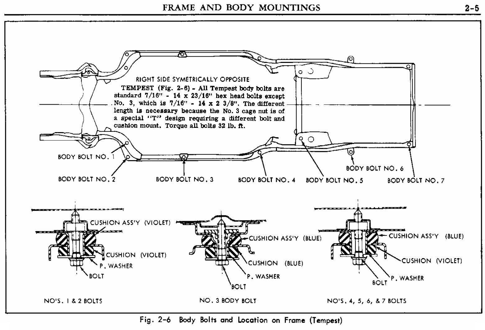

A few versions of late B- and D-bodies were intentionally built with some of the bushings absent from some of the frame mount pads. This was done to help "float" the body from the frame to isolate it and provide a softer ride feel. However, all the the locations using bushings also used bolts into the weld nuts in the floor pan.
My guess is that intentionally leaving bushings out of some positions would not have been done with a Tempest/LeMans/GTO.

Maybe this is a little clearer:
