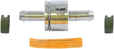

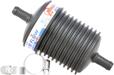

Re: Eliminate Power Steering?
ABSOLUTELY flush the PS fluid!
Once the fluid is flushed, install a filter to take care of any remaining bits.
https://www.napaonline.com/en/p/PNB351004
https://www.napaonline.com/en/p/PNB351002
They're sold by the hose diameter they fit. ^^^ These fit 3/8 return hose. there's other styles, but they're all about the same deal.
