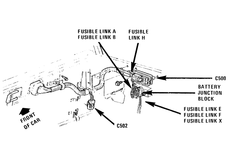

This may help:

Awesome stuff !!! I see the front of the car arrow in the sketch. However, where exactly is the battery junction box.

That junction block is in the right side bulkhead of the engine compartment, just to the right of the battery.

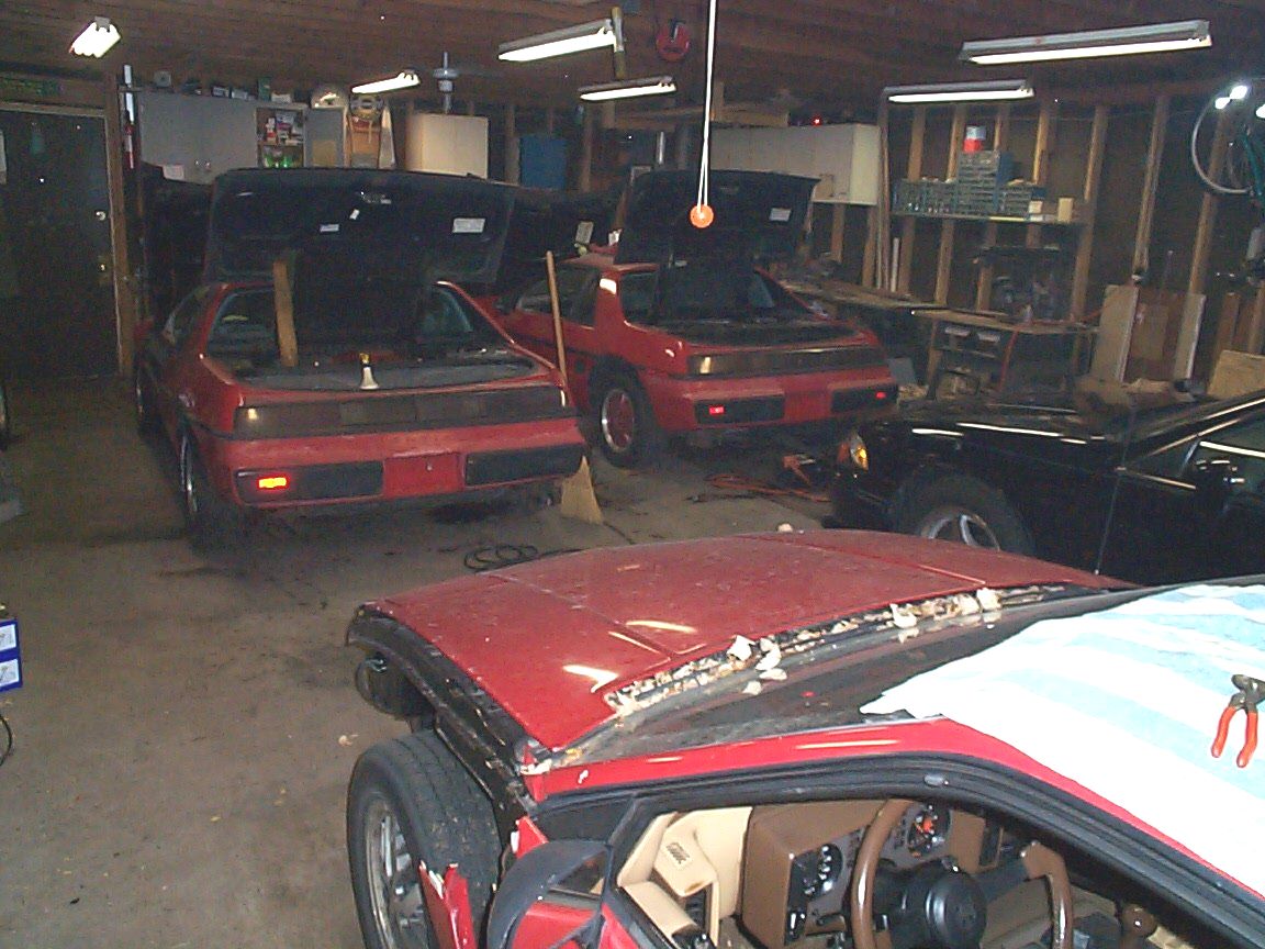

I'm a touch over 6' 4" and I liked the copious amount of legroom. I could get all of my hockey gear in the passenger seat and the sticks into the car (they were quite long since I played defense). There wasn't a lot of storage space elsewhere in the car, but it was O.K. as a commuter. On skinnies it did pretty well in winter - Exceptionally well on ice. They did have their flaws, but GM has made several version of worse cars since then.
