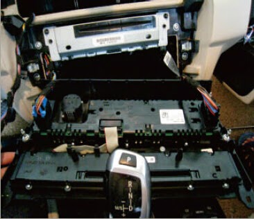

5.Remove the 2 screws for air conditioning pannel with screwdriver.
[IMG]https://images-blogger-opensocial.googleusercontent.com/gadgets/proxy?url=http%3A%2F%2F1.bp.blogspot.com%2F-mL0r1XNiIYY%2FU56TxS--XmI%2FAAAAAAAAAMI%2FZHsQLZUrOGw%2Fs1600%2F5.jpg&co ntainer=blogger&gadget=a&rewriteMime=image%2F*[/IMG]

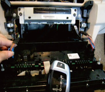

6.Release the air conditioning pannel with crowbar.
[IMG]https://images-blogger-opensocial.googleusercontent.com/gadgets/proxy?url=http%3A%2F%2F1.bp.blogspot.com%2F-sMhg096mkZQ%2FU56T2A8K3iI%2FAAAAAAAAAMQ%2F85Qw6oPn rlk%2Fs1600%2F6.jpg&container=blogger&gadget=a&rew riteMime=image%2F*[/IMG]

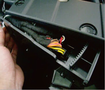

7.Plug out the cable of air conditioning panel and take off panel.
[IMG]https://images-blogger-opensocial.googleusercontent.com/gadgets/proxy?url=http%3A%2F%2F1.bp.blogspot.com%2F-6jfYw84bf0U%2FU56T6LbUwoI%2FAAAAAAAAAMY%2Fak045whn rJc%2Fs1600%2F7.jpg&container=blogger&gadget=a&rew riteMime=image%2F*[/IMG]

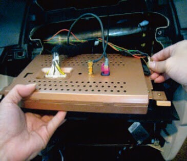

12.Connect the oe power cord to our power cable.
[IMG]https://images-blogger-opensocial.googleusercontent.com/gadgets/proxy?url=http%3A%2F%2F3.bp.blogspot.com%2F-atr8IZ9sA6k%2FU56RvBssi7I%2FAAAAAAAAAJI%2FI_onDtyc BxA%2Fs1600%2F12.jpg&container=blogger&gadget=a&re writeMime=image%2F*[/IMG]

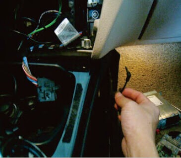

16.Make AUX terminal from back lower place of gear console go through to the oe AUX socket.
[IMG]https://images-blogger-opensocial.googleusercontent.com/gadgets/proxy?url=http%3A%2F%2F3.bp.blogspot.com%2F-LdT0gTVaRek%2FU56R_I5qMvI%2FAAAAAAAAAJo%2F644TTR6Y aro%2Fs1600%2F16.jpg&container=blogger&gadget=a&re writeMime=image%2F*[/IMG]
17.Plug in the AUX terminal.
[IMG]https://images-blogger-opensocial.googleusercontent.com/gadgets/proxy?url=http%3A%2F%2F2.bp.blogspot.com%2F-tRdZpFWO8BA%2FU56SDaD0nQI%2FAAAAAAAAAJw%2FWEpKxoyR atI%2Fs1600%2F17.jpg&container=blogger&gadget=a&re writeMime=image%2F*[/IMG]
