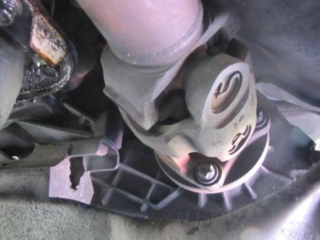

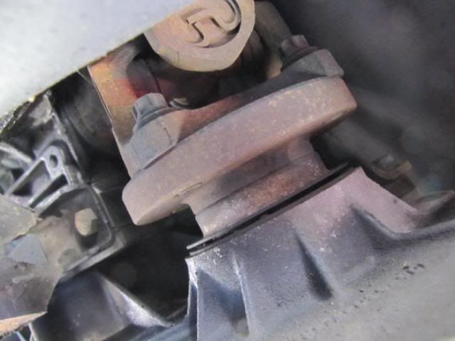

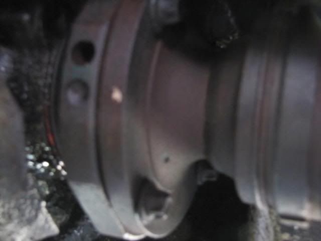

Yup, it's different from what's shown in the FSM. Looks like 8 bolts and you're off to the parts store.
Here's some pics,
Rear joint at transfer case flange
Front driveshaft-front joint at the front differential
Front driveshaft-rear joint

The front joint is a CV joint, here's a pic link,
http://www.wholesaleimportparts.com/...shaft_1992.php
