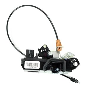

Does anybody have a picture of the part I need and where would I buy one at?

Re: driver side back door will not lock automatic
http://ecx.images-amazon.com/images/...vL._SY300_.jpg
Looks like that.
