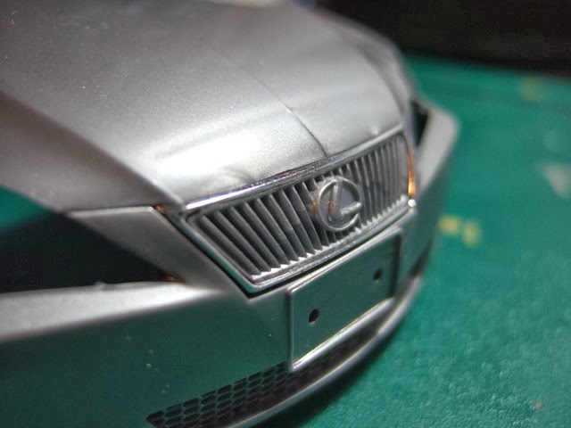

First sanding with #800. Some dents were found, but still not so deep so that easily I could sand off.

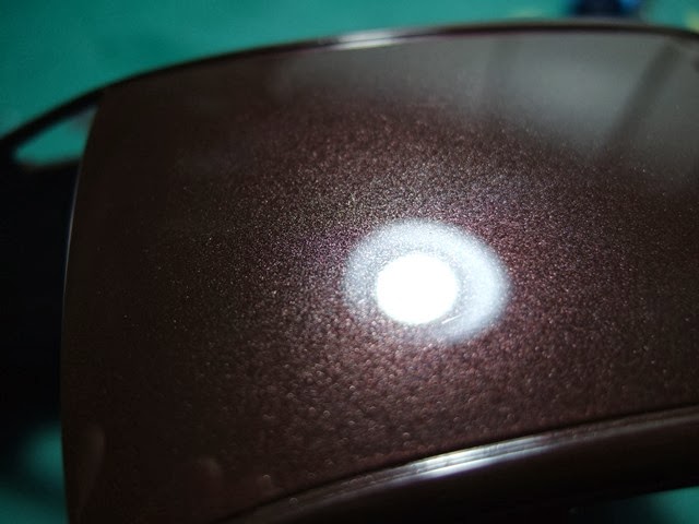

This is the picture after Super Clear applied. I can say the sanding or polishing are almost not needed (actually I will).
The gross on the bonnet is not enough, but on the fender or around the head lights are almost perfect, 'cause I made the airbrush "stay" fairly long (You could say I should have done the same thing on the bonnet. Yes, I should). I should have applied more clear at the same time on the bonnet to save my time to polish. But I also know, this "Orange peel" would disappear once some sanding process were taken place.
Side body also shows almost perfect shine. Muum, I should have used this method on last GTO, I don't know why I didn't trust my good-old method.

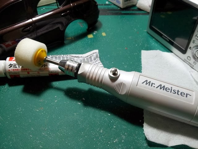

The polishing process has been started on my Lexus.
#3000 Mr. Hobby's Polishing Cloth, and #6000 Laplos, then Soft 99 Fine Compound applied.
After every process, I washed with dish washing detergent.
Then Tamiya Course Compound applied. Still fine scratches were seen, but these would go away after the next step.
Tamiya Fine compound applied. most of scratches had gone.
Tamiya Finish Compound applied. I am happy with this result!!
These are the weapons for this build.
"Sujiborido's micro polisher 123" on Toyo Associates' Mr. Meister Pen-type motor tool "PT-αⅡ". To apply compounds with this combo, I set the rotate speed very low.
These combos made the job much easier and quicker. I don't feel any numbness on my hand.

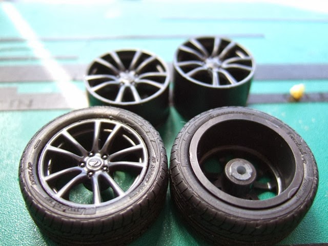

Muhhh.....? I can say the wheels look a bit small now. It's a kind of fair seeing the pictures, but if I actually have a look with my eyes, still... yes, they were small.
Then I tried to "inch-up"... oh, this was what FUJIMI meant!!! (It's not, as you knew)
I applied 0.25mm plastic paper, 2 layers. This was, 1mm-up for the 1/24 wheel, meaning about 1 inch up.
Slightly inched-up.
Then applied silver paint for the test fitting, please ignore the rough surfaces on the wheel rims.
It was fairly looking... fair. I felt it still plain.
Then I tried this. Looking super cool!!!
To fit Aoshima's wheel to Fujimi's kit, I needed to slim the axle.
...Still showed the negative camber, also the height of the body was a bit high.
I found the wheel rim was hitting to the shock spring. It's a bit rough solution but I scraped the spring. Don't care what we can't see...lol. And, top of the shock absorber were 1mm cut off to low down. I attached 1mm cut plastic pipe to the lower arm to fit the low-downed shock.
To fit to Aoshima's loose hole (I can say Fujimi's pin is too skinny, anyway they were from other makes), I simply attached slender masking tape.
Now it's good! Centre gold parts were re-painted in Tamiya's enamel Gold Leaf (X-12? as I remembered) 'cause the original surface was a bit rough.
There was no need to adjust the height or width on rear ones.
