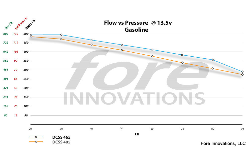

Now looking at the flow chart for the Walbro 465 shown here: http://3.bp.blogspot.com/-NJWhwL9iIy...-465-13.5v.jpg
If I was to lower the base pressure this pump can supply more than enough fuel to satisfy my calculations, that is based on the assumption they are correct.
If I was to remain the base pressure this pump would fall short of satisfying my calculated flow requirements, I will be able to increas its flow by using a Fuel Pump Booster by running the pump at 17.5V.

1) Reduce base pressure to 3.0bar and install single Walbro DCSS465.
2) Retain base pressure at 4.0bar and install single a Walbro DCSS465 and voltage booster to increase flow.
