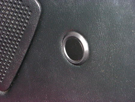

I mounted the switches in the center console behind the shifter with a door lock switch as well. The switches all look the same, they are just black rocker switches. The hole in the door was plugged with a piece I had made at a machine shop. I used the plastic ring from the factory window crank, and had a metal disc made with a stud on the back of it. I put the disc on the ring and with the same size washer on the back, used an 8mm nut on the stud and secured it to the door panel. The discs were powder coated black to match.
