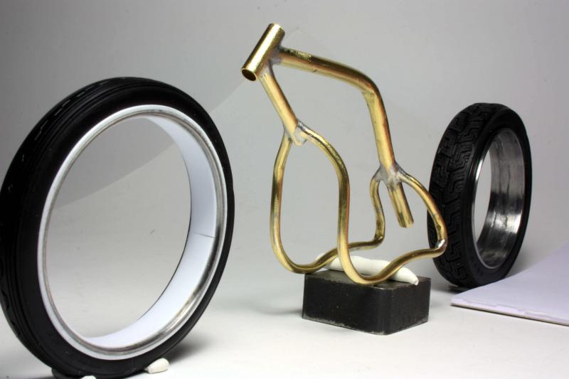

BMW Kaffee Böbber 1/9

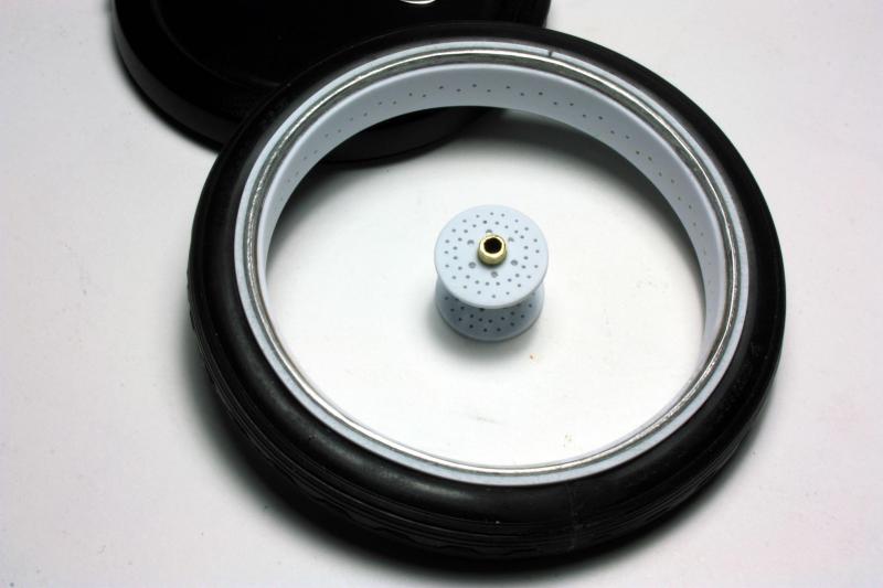

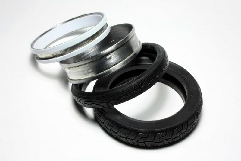

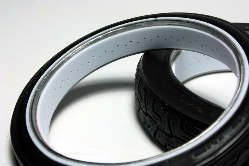

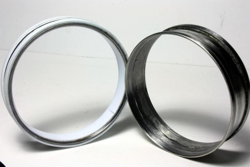

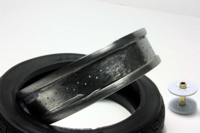

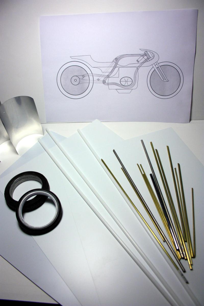

No one model completed that I start a new one ..

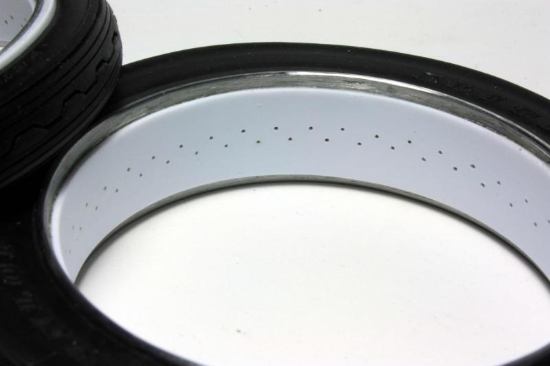

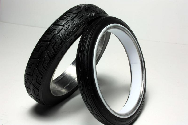

I started scratchbuilding from a couple of cans of sauce, cutting the bottoms , then filed and welded together (luckily it is steel, and I welded it with tin..)
The tires came from an Harley 1/9 kit, the front one has been cutted, because it was too large and glued to himself , to fit the rim..

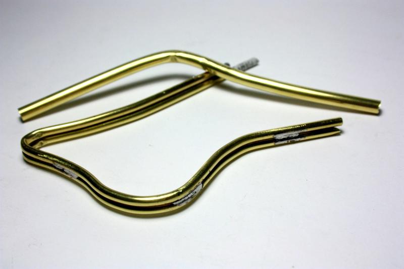

Re: BMW Kaffee Böbber 1/9

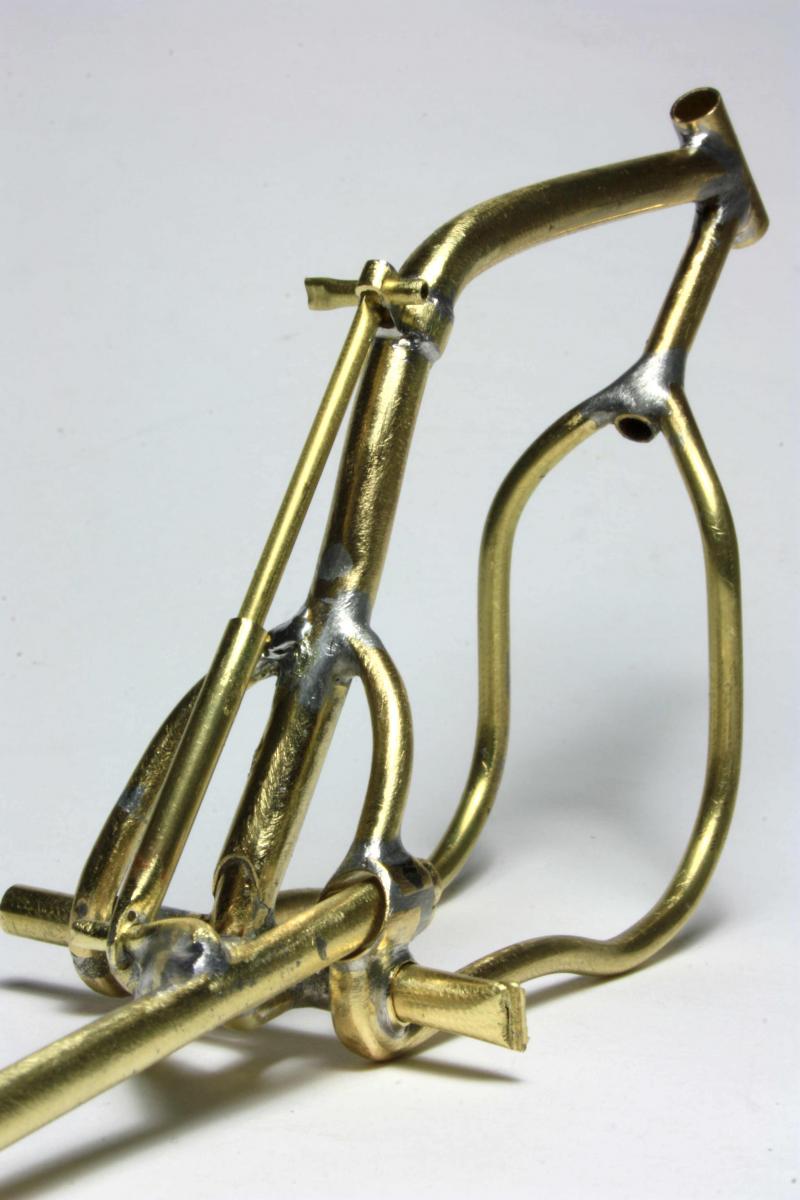

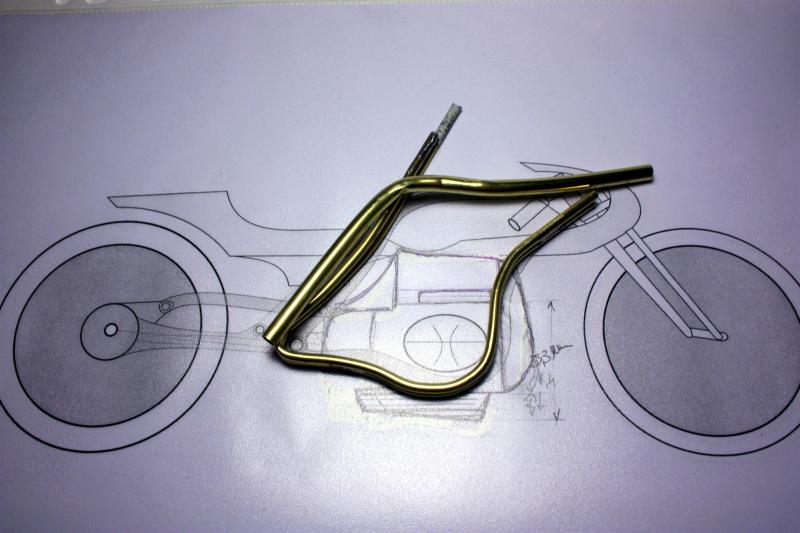

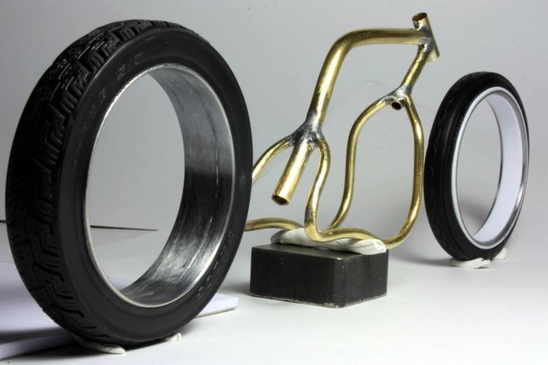

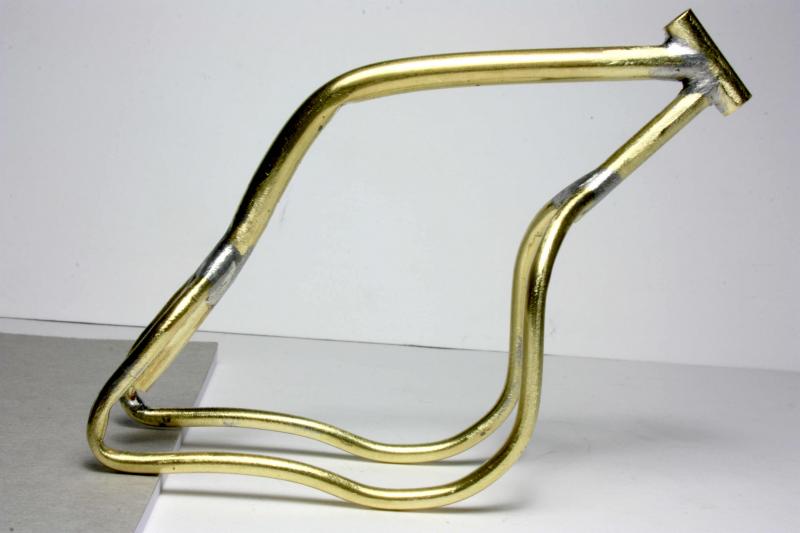

Another piece of the puzzle:
Frame part 1..

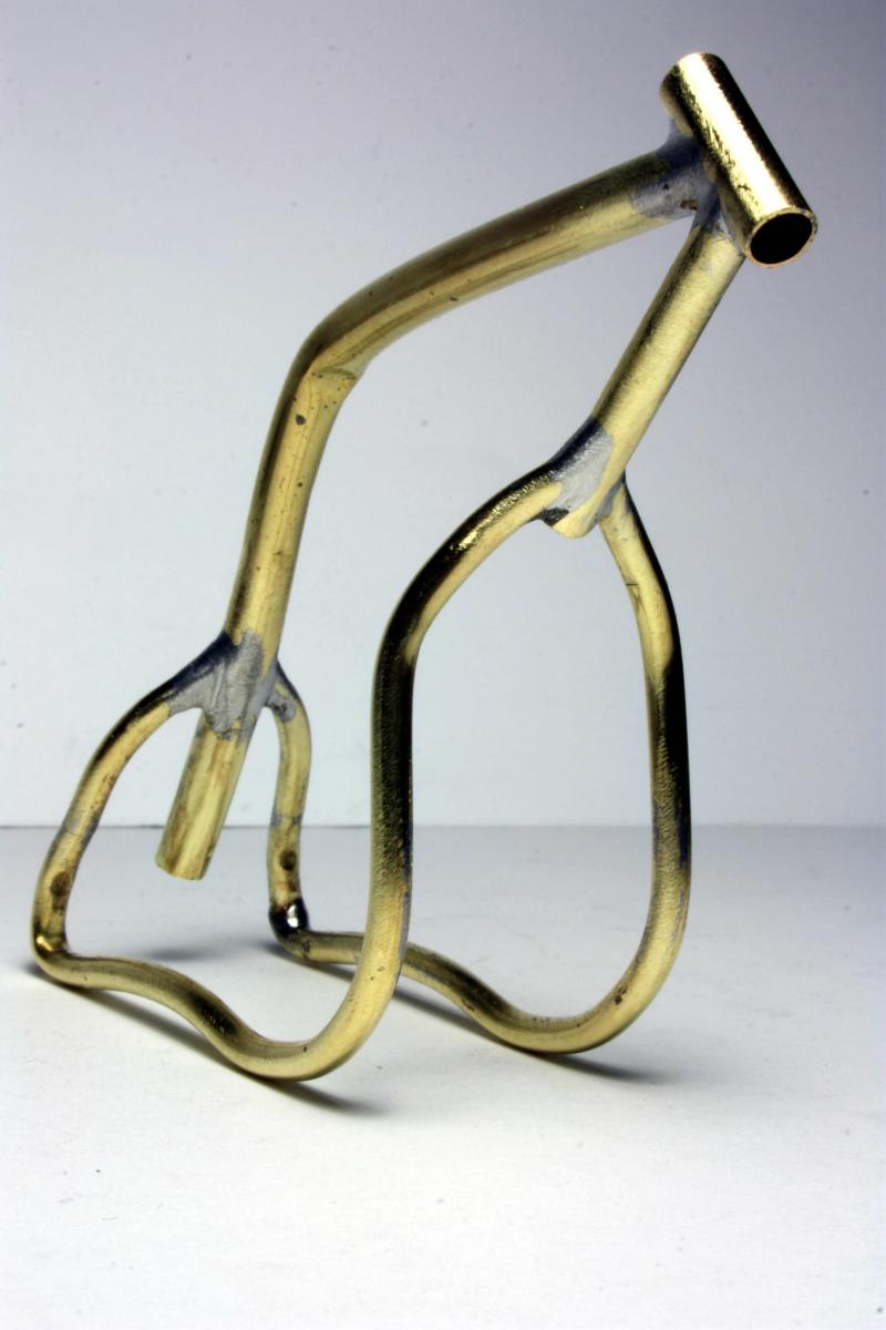

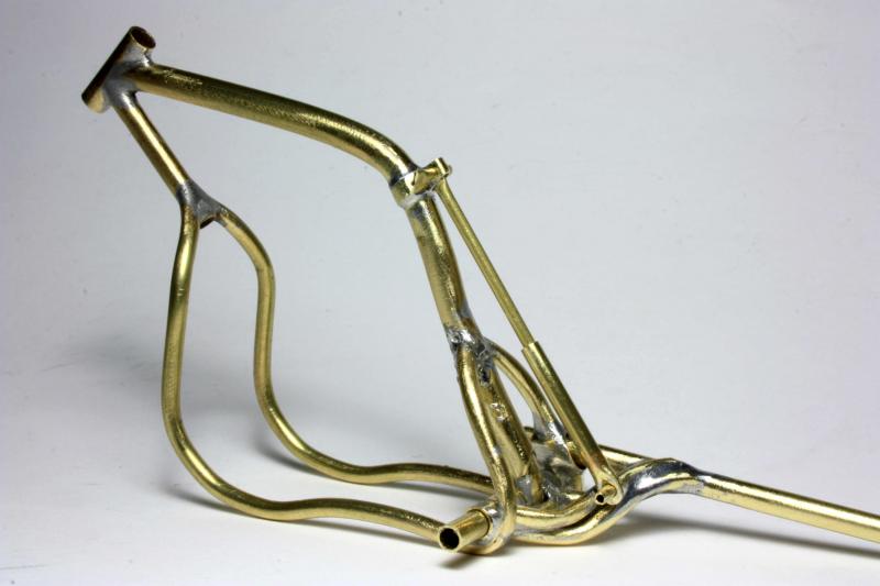

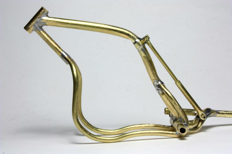

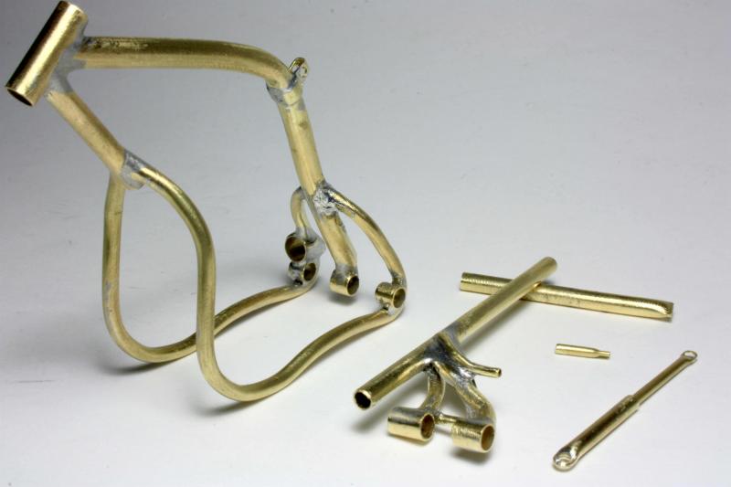

Frame part 2, and swingarm..
Very interesting project!!! How do bend the brass tubes?
Thanks!!
@utzelu: nothing special: only hands and only something to use as a cylindrical support, that helps to bend tubes..

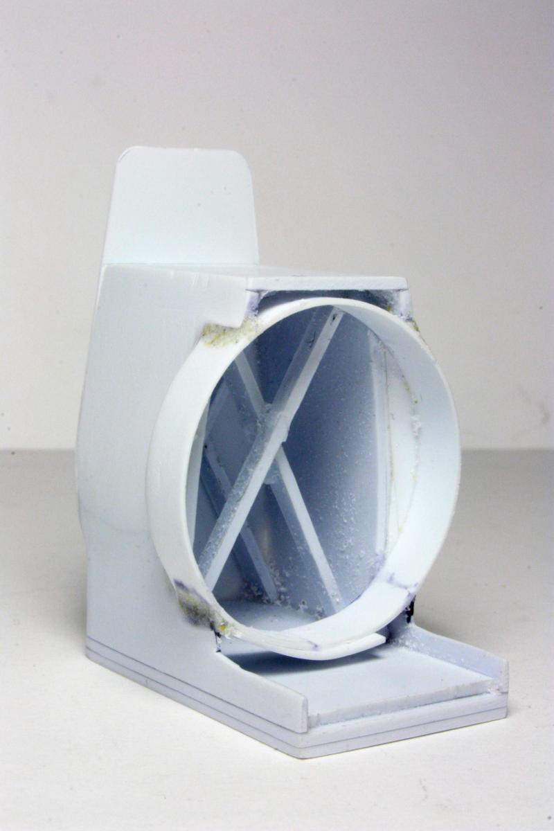

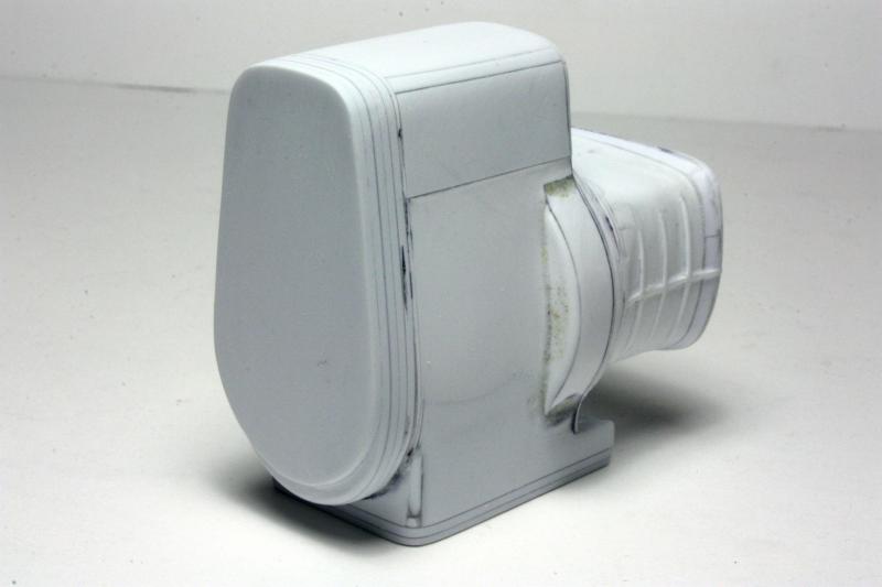

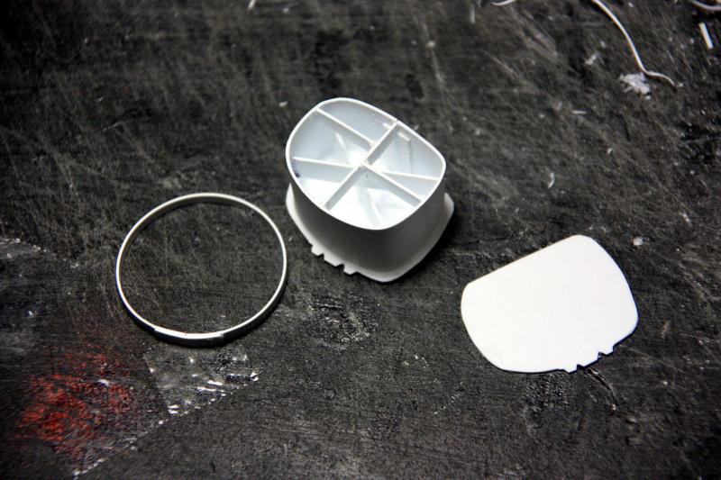

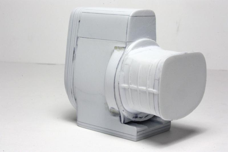

Starting with the engine..
With 1-0.5 mm plasticard and some computer drawings, I've scratchbuilt the engine block
Fantastic ! I thought you´d take the engine from a 1:9 Revell kit, but your way is amazing

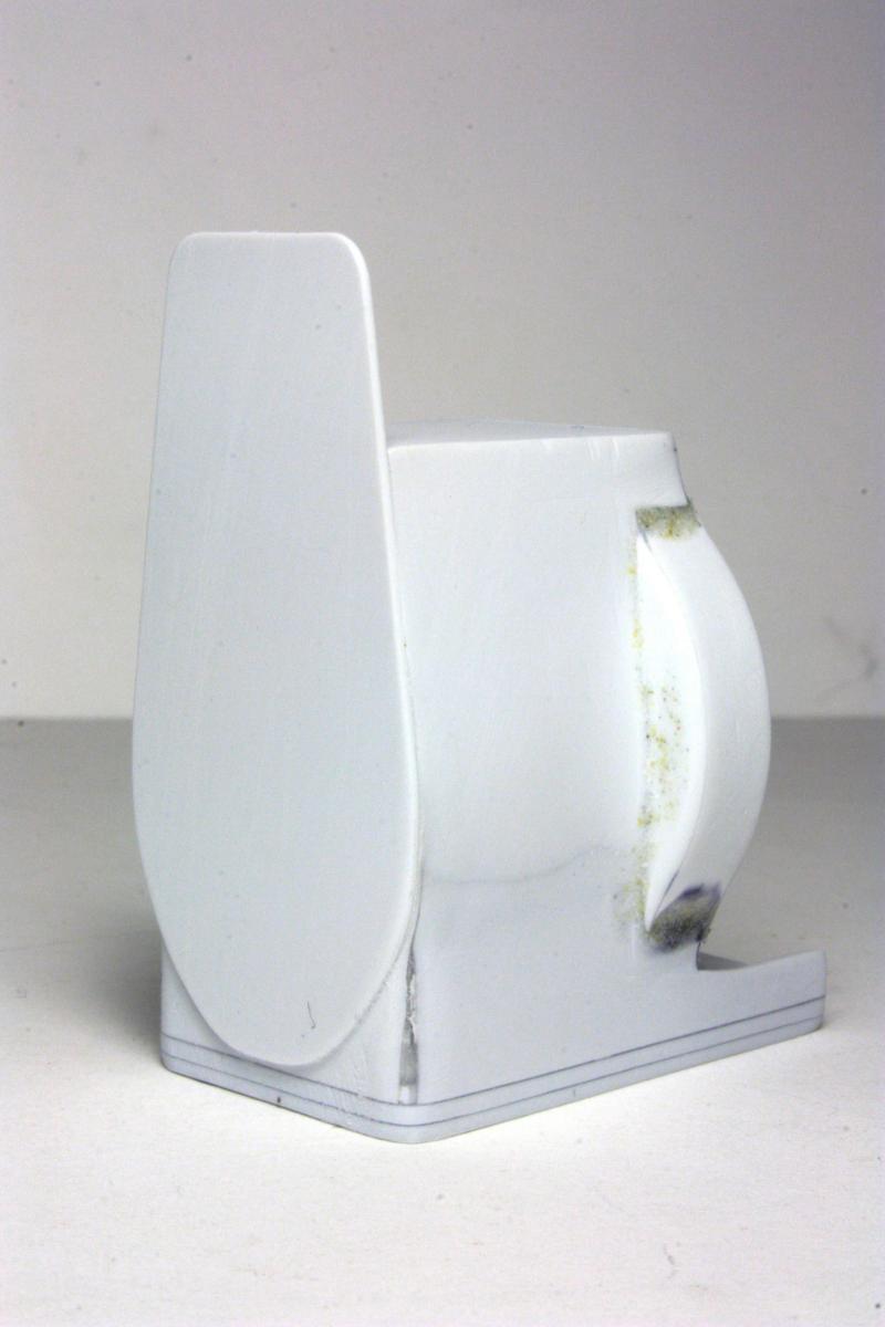

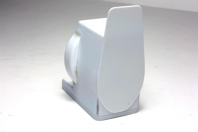

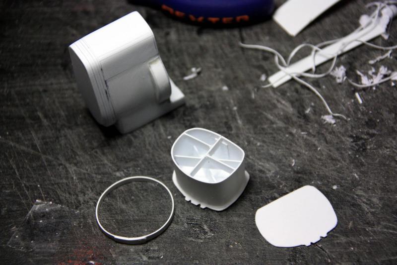

Thanks sportracers!
Engine block, part 2...
