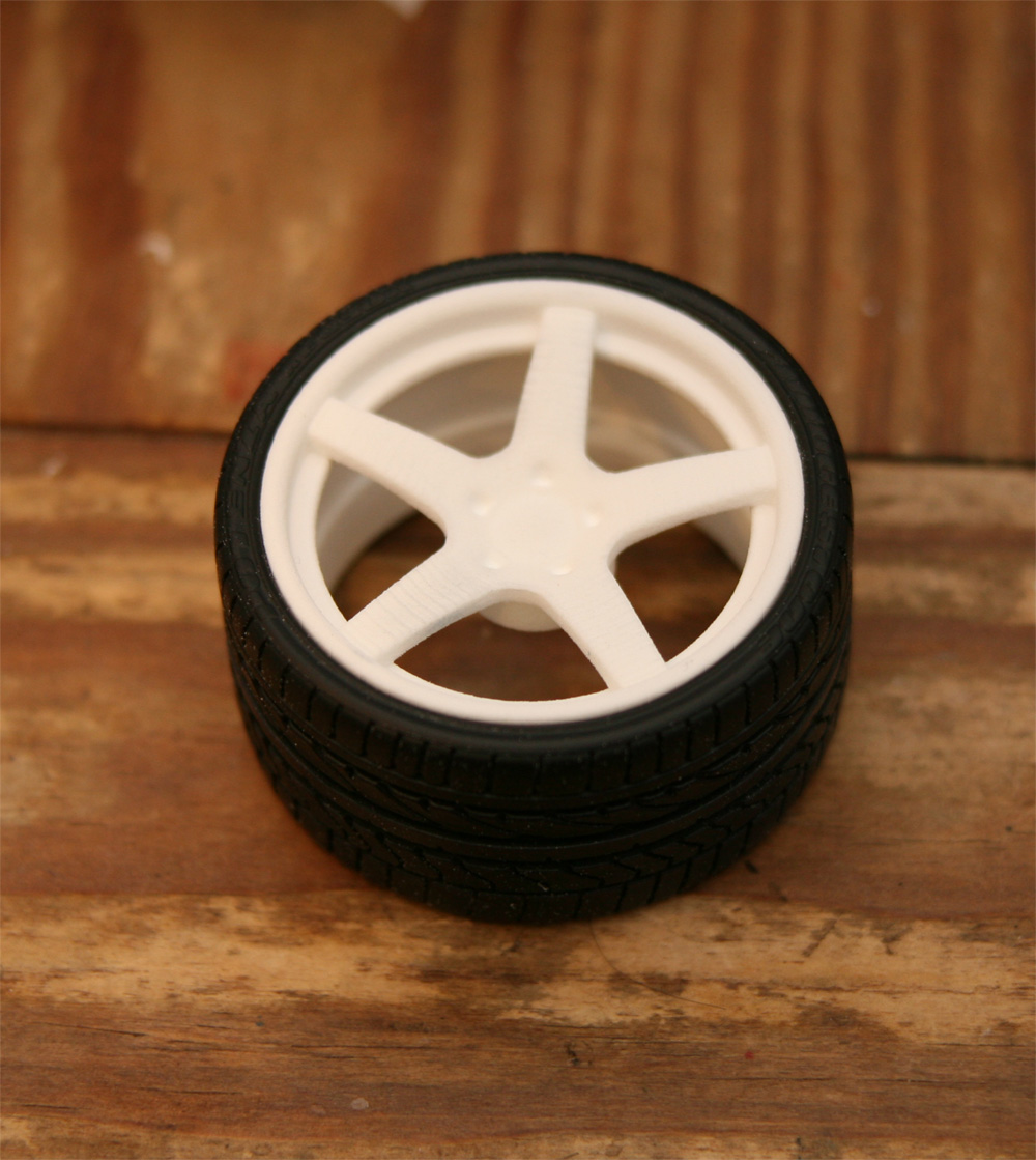

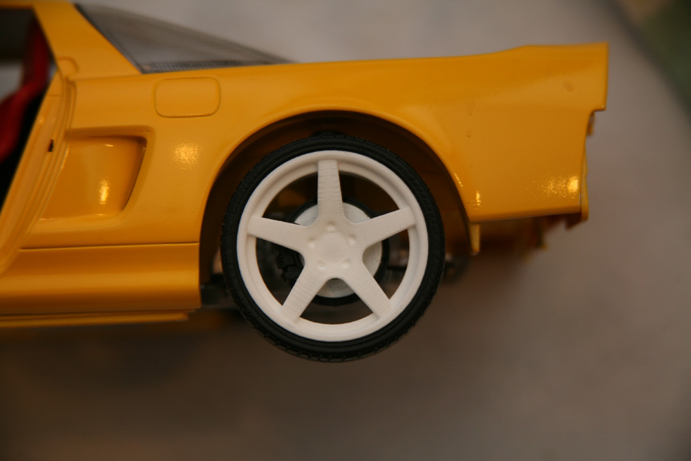

I thought I share this with everyone. I just received my 3d printed wheel for my rosso NSX project.
i used the strong and flexible plastic since it was cheapest for test fitting.
Its not smooth at all and you can see the layers. I believe the fine material will have very smooth surface.

Nice!! Lucky to have a Rosso 1:12 NSX!!!! Id be interested to see how the fine detail material comes out

You've solved it! I have been letting this kit sit at the back of the shelf until I could figure out how to find some good, aftermarket wheels for it! Shapeways? This is a great idea!! Your wheel looks fantastic. Are you going to have them make all 4 or will you get only one and cast the others? I'd be interested to see how this plays out.

thx guys.
The fine detail material is quite expensive almost 2x the price of this.
I might just make the faces and have machine shop make 4 barrels if its cheaper.
The rims will use tamiya enzo tires. I see the new porsche cgt will be out soon and maybe it has diff tires. I hope they are smaller.
Oh yea you can use the brakes and seats off the enzo. Seats are big so u need to mod them to sit lower.
