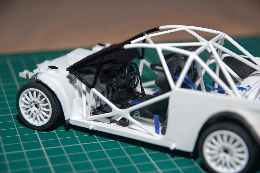

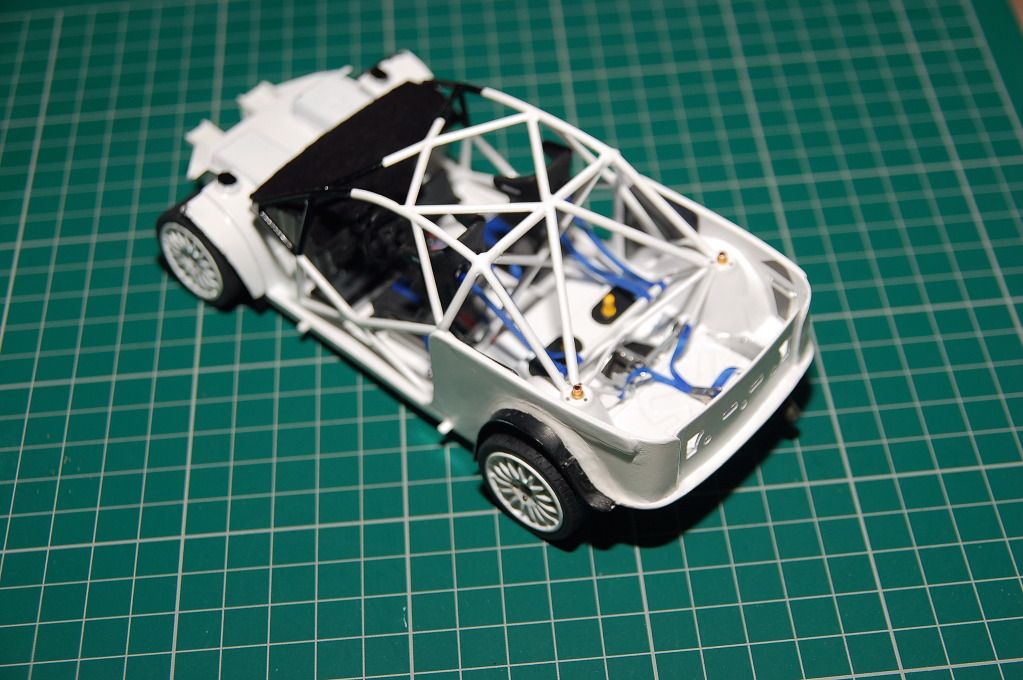

I hope I can make some improvements to the kit build, mainly addressing the glaring gaps that exist because of minimum chassis. Every single part takes a good amount of cleaning up and I started by filling all the sink marks in the chassis.
I made rear internal rear quarter panels from plastic credit cards as shown:
The rear part of the cage needs some rework as the two diagonal bars that go down to the strut tops are too short to reach it! These were replaced with Evergreen plastic rods of the same diameter as the kit.
I also added some extra bars in the front footwell area up to the front bulkhead.
[/IMG]
I was fortunate to visit M-Sport recently and they have this Focus in their small museam so I managed to get a good set of detail photos.
There is a elec control box mounted integral as part of the pedal box so I built this from scratch using parts from the Renaissance photo-etch kit. There is a carbon fibre guard that sits adjacent to the tunnel so this was incorporated to this part.
This next picture shows this in situ.
I've also made wheel arch liners that will fill the voids on the standard kit.

The chassis is nearly completed and all these parts fit with no problem.
The inner wheel arch liners are black.
