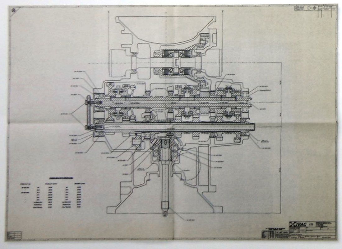

You'd likely have a better chance of getting a response from the folks at Weismann than you would trying to contact Leno.
They did mention in the video that a copy of this drawing is in "the book" which I assume could only mean "Driving Ambition". I've just checked and the only similar drawing I was able to locate was that of the Xtrac GTR gearbox which you can view here:
The Limited/Owner's/Le Mans copies of DA include a full sized engineering drawing and the one I have with mine is of the 'Gearbox - Maincase' which is different. I just looked to see if I had any reference to another one showing the Gearbox internals and I don't see anything in my archive. Perhaps a couple of the other people reading along here who have the Limited versions of DA could report in on what drawing their copy included?
When I have some time tomorrow I'll unbox my Limited copy and skim the pages of the 'Gearing Up' chapter in order to see if there is any additional content there that didn't make the cut for the retail copy. Perhaps that is the book the Weismann guys were referring to?

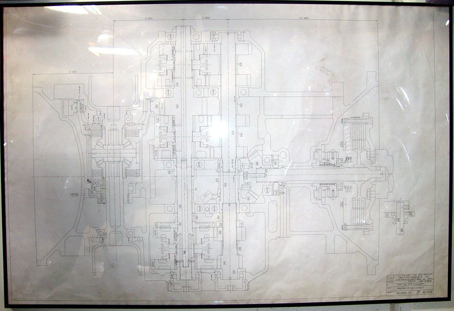

Old 03-02-2012, 04:07 AM
Peloton25's Avatar
Peloton25 Peloton25 is offline
McLaren Fanatic
Posts: 8,632
Thanks: 714
Re: Transverse gearbox
Found this hanging on the wall in someone's Garage.
It's a very similar drawing as the one I posted above, just rotated 90 degrees and with added detail. If you click on the image above it will open a high resolution version.
>8^)
ER
