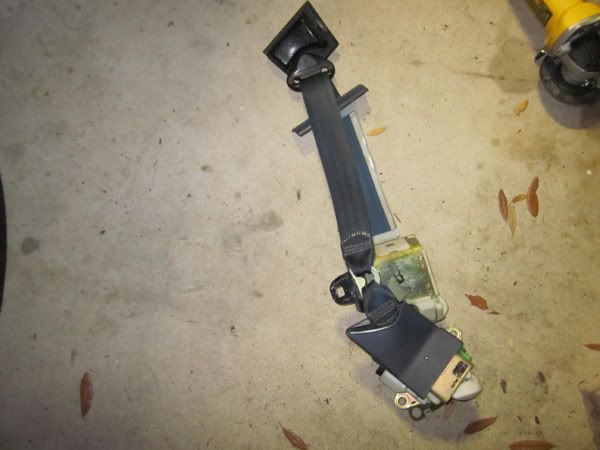

Door panel off, now removing the seatbelt assembly.
Its held on with 3 nuts, pretty simple.
The belt is secured to the door with this metal bracket at the bottom of the window. Huge rivets, taken care of with the grinder.
The top loop/striker in the window is a little more tricky.
The plastic cover pops off from the outside revealing 3 bolts: 2 top, 1 side.
You can remove the nuts, but at least the side bolt has to come out to remove the loop/striker. I'll be taking out all 3 anyway and filling the holes.
To get them out you have to pull back the weatherstripping outside and rotate the bolt correctly to pull it out of the channel.
The little bugger
Now you should have your complete 90 seatbelt assembly ready for ebay.
