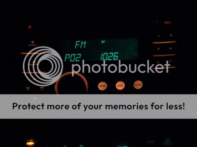

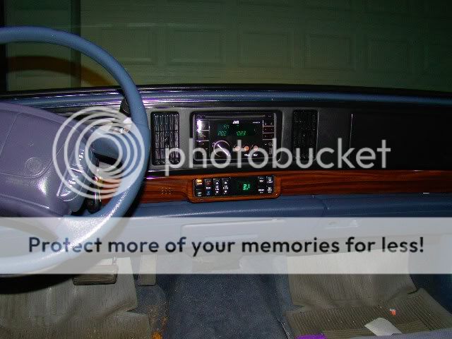

Here ya go Chris,
1) Before bezel installed
2) At night with flash
3) At night, no flash (60th of sec, 400 ISO, F 3.5) I couldn't slow the exposure more because the vibrations of the car made things blurry. IS >400 doesn't look good from the Sony H50. However, you can see the display and botton colours. If I worked more at it, I could probably match the colours closer.
Sorry, I could not get the pictures to upload here, so I'll leave the links.
All in all, I love the look of the head unit. Its conservative looks blend nicely with a Lesabre. Probably my biggest complaint is that the display is completely blank at night with the stereo off. It kinda leaves a big black hole in the dash at night if I'm not using the stereo. Also, I cannot figure out how to get the clock to display full time with the radio off.
The display during the day so far is very readable in a Lesabre. I'm not noticing any issues with glare. I'll update is I discover any issues in that regard.
Lar

Old 06-22-2011, 11:39 AM
HotZ28's Avatar
HotZ28 HotZ28 is offline
AF Moderator Elite
Join Date: Feb 2005
Posts: 5,764
Thanks: 87
Thanked 72 Times in 72 Posts
Re: stereo wiring & dual climate control
Originally Posted by enslow
The reason I'm posting all this is because no one on several forums seemed to have answers for my questions, and there appeared to be no solutions posted in any forums as far as I could find. Maybe I'm a complete idiot when it came to installing this stereo, but I don't think so. I've installed several head units in the past with no trouble at all. I've solved several wiring glitches that dealerships couldn't solve, but knowing there can be idiots working in dealer shops too, that might not be much to boast about.
In spite of this being somewhat verbose, I hope some one finds this useful in the future. I'm sure these issues apply to more than just a 1999 Lesabre, and to more than just the JVC KW-XR610.
Thanks Lar for the excellent writeup and technical advice. We may move this thread to our Tips & Maintenace Procedures forum. BTW, I downloaded the pics for you.

Old 06-22-2011, 06:01 PM
happydog500 happydog500 is offline
Join Date: Sep 2004
Posts: 764
Thanked 4 Times in 4 Posts
Wow! looks nice! Last year when I had lots of money crutchfield told me there was no stereo I could put in a Lesabre without using the adapter for the smaller units. Now when I'm broke, I find they have one.
I want the time to show, so please let us know if you get that to work or it's not possible.
