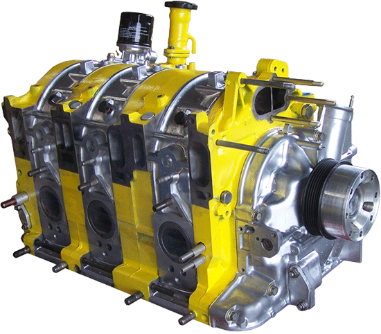

Hi folks! I'm planning to build an RX-7 FC3 with 3-rotor engine the 20b. I've seen TIU's Veilside Fortune RX-7, but I need help on choosing how thick material I should use to manufacture the 3-rotor engine. I know I need to get some Evergreen sheet, but what would be the best thickness for the sheet (please use metric measurements, I don't understand inches). I think Jimmy knows best, which thickness to use, not that I won't appreciate everyones insight and knowledge. Here's a photo of the engine:

I bet the petroleum industry loves that monster! Seriously, just get the assortment packs: 9002 and 9008. Most hobby shops stock them. There will be enough to build up any thickness. In direct answer to your question the housings should be 3mm, the irons 2.8mm in 1/24th. Thats based on measurements from my 13B in the garage.

Those were the measurements I got when I fabb upthe 20B's little brother...my Cosmo 13B-RE just as CrateCruncher said. I used a combination of 1mm and 0.5mm styrene sheet to make my components. Just remember that the first intermediate housing is thicker than the second one...to me...a little less than double thickness.
