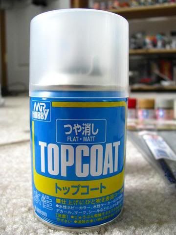

I have quite a few models that I have used the Top Coat on, built maybe 3 years ago and they still haven't yellowed yet. I usually apply 2 light coats and two wet coats, with 5-10 mins between each coat. I then leave the parts to dry for between 24 and 48 hours before I polish. If you can leave it longer than this it will be better though. A week is good...
Most online hobby shops stock the Gunze Top Coat try Hobbylink Japan, Hiroboy etc. The best clear I have used is Zero 2K, available at Hiroboy.com, but it's airbrush only, so for now if you have no airbrush it's not much use to you, unfortunately... Because it is really good stuff....

Thanks a lot for the reply. Just as confirmation this is the product right?

The picture you posted is their lacquer based product. It's still very good, but you have to be careful with it over decals.
This is the water based version that I used. Ignore the fact it says 'matt' finish it also comes in gloss and semi gloss as well...
