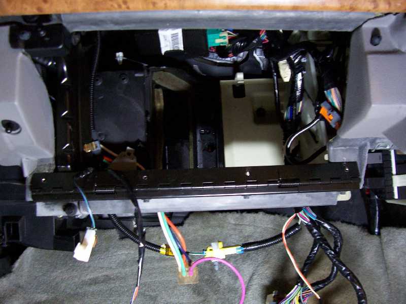

I cleaned up and resealed all the dampers I could access when I changed the heater core. I also had to remove the blower changed the resistor, so most of the system was wide open. I had some difficulty with the RH (upper) damper motor and worked that over as well. Between all the activities (new core, new resistor, repaired damper motor, new weatherstrips) the problem was solved.
Before replacing the core and sealing the doors, manually disconnecting the actuator linkage from the nylon clip and moving it full hot still didn't solve the issue.
I was able to get to most of it through the glove box opening:
