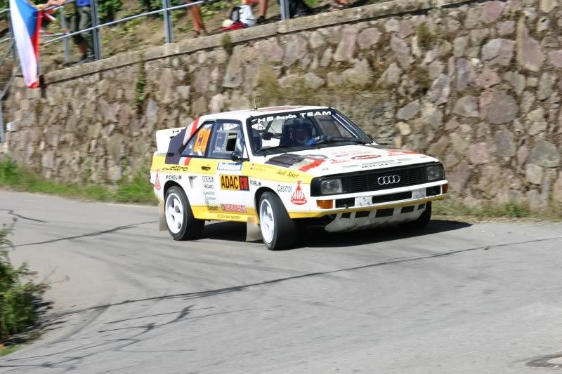

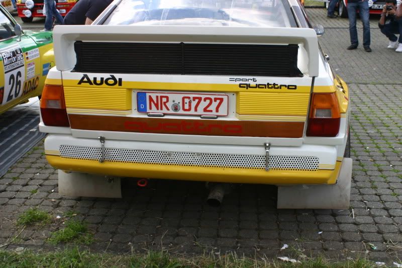

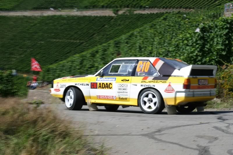

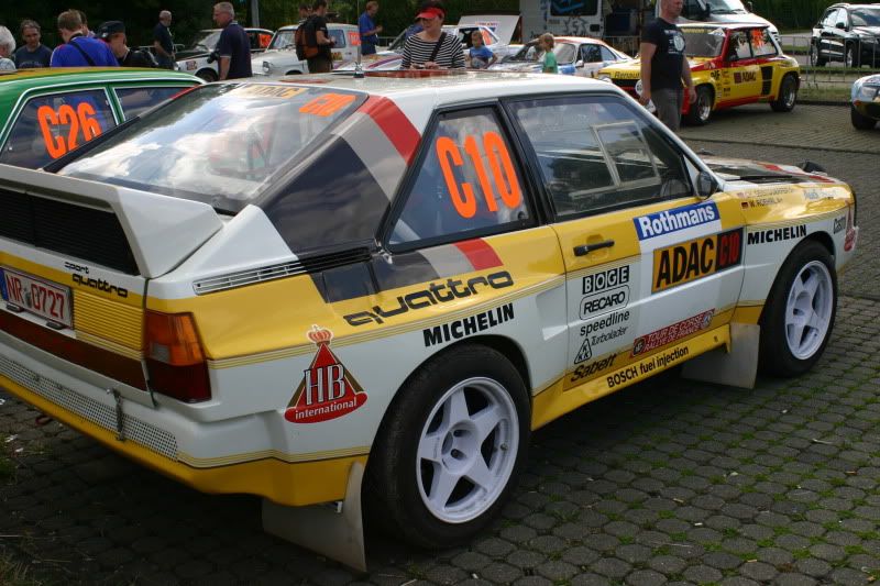

Hi Roman,

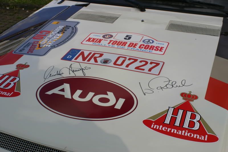

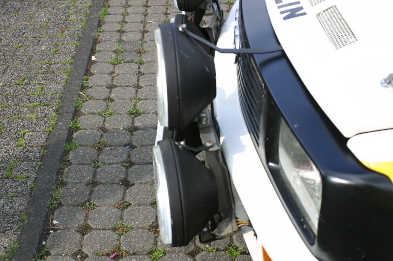

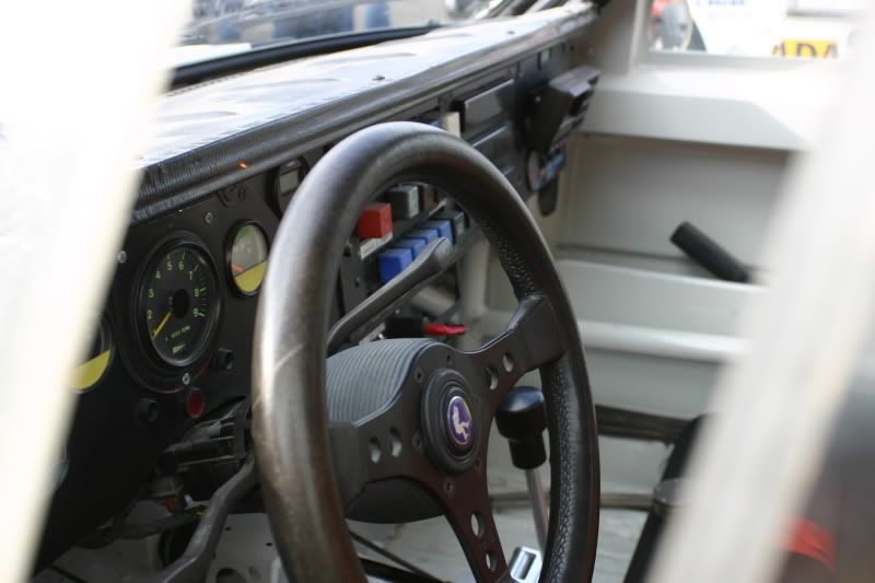

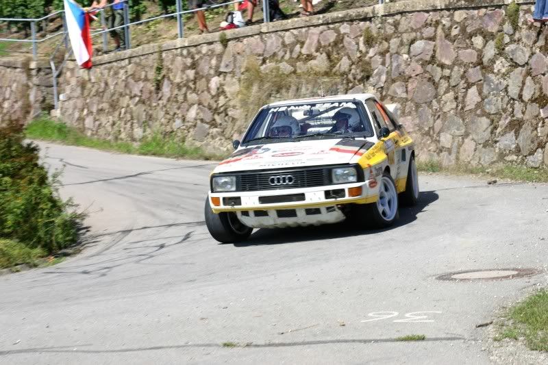

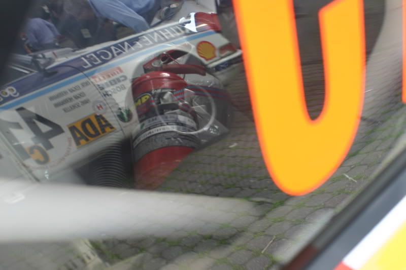

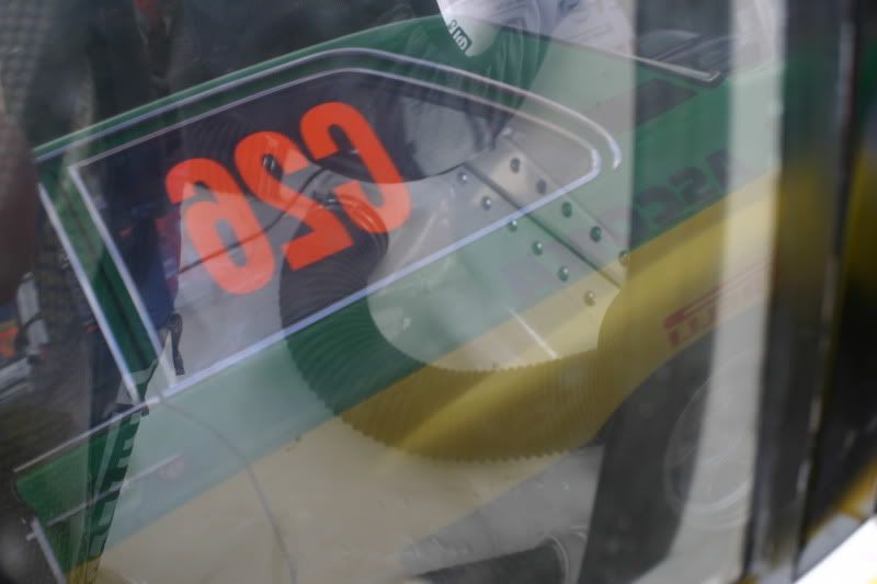

here are a few pics of the Sport Quattro which entered the historic part of 2010 German Rally.
I wouldn't swear it's a fully original one and not a replica, but some things can be usefull in building the scale model.
Air ducts, falling from air intake in rear wheel wells...
... joining in the middle of the car, under spare wheel (when there, wasn't in this case) and above transmission they cool down through body frame.
Not sure fire extinguisher is where it was supposed to be in original car, but historic car have to use modern rules security systems as belts, seats etc... this may be part of it.
Hopping this may help
You have a lot of courage to modify this poor Reji replica when Scale Production release a nice kit (I still have to order not to miss it BTW...!! )
I'll follow it as the A2 Quattro.
Phil

Phill Thanks you for photos. It is very interesting.I have noticed that a lattice in a back part as at S1.On other cars I did not see such.Probably each of constructed Sport Quattro has differences from others.

Because you modify de body in such a detailed way, I just had to point something out. On the original Sport quattro rally cars, the front grille with headlights was similar to the one on the street versions. Some have small closed rectangle areas in the lower corners and some haven't.
The headlights should therefore be bigger and less square. On your model, they are really square.
The car you posted pictures of has the grille of the S1, so not original for the Sport quattro.
Here are some pictures to illustrate that:
Street version:
Original rally version:
"Your" version (I think it's the 1985 hillclimb version):

You're welcome If you want to make the original rally version, you should make it with the bigger headlights, like the ones in Rallymaster's post. The smaller headlights are incorrect for the rally version.
