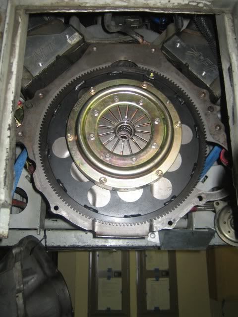

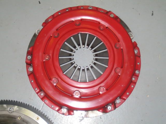

Ok, its done. I made the change. I took a nice McLeod Clutch and upgraded to a Pro system. I am currently working on the winch install in the trailer. This thing is like a switch. On or off and no modulation. Removed 10lbs. off the rotating assembly and decreased the torque load on the motor with the smaller diameter. We will see how it works labor day at PBIR.

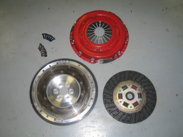

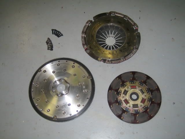

If anyone is interested in the Clutch/Flywheel I removed here is the details.
I just had the McLeod unit inspected by an authorized dealer and it’s all in great shape according to promotion powertrain (www.promotionpowertrain.com). It also has the upgraded 5 strap downshifting road race upgrade and the aluminum/iron pressure plate road race upgrade to save weight. I checked and the pressure plate (special upgrade RR edition) I have is $639 and the clutch friction plate is $200 plus the $329 anderson lightweight flywheel. All with less than 20hrs on them. They will go up for sale very soon on ebay but would like to keep it in the family. I will sell seperately but would like to sell together. I have new bolts for the pressure plate to flywheel included. New pkg. was $968 but current prices are more. I would like to get $600 for it considering the low hrs. that seems very fair. I will consider any offers though.
360048-5A - http://www.mcleodracing.com/products...mcl?rsku=15840
AF-SLFW50 - http://www.andersonfordmotorsport.co...chk=1&Itemid=1
Unit works fine. A little tricky to install but I think I have it figured out. Handles over 700 FWHP.
I also have a Mighty Deamon 650cfm carb with about 3hrs. of use including the AN and braided SS dual pickup lines. It was too much HP for the NASA ST1 class I run in. It was on a 427 stroker Windsor motor that put out 600 FWHP. I sold one of these just like it to another Panoz owner for $450 so that is what I would like to get for this one as well.

Nice Brian, looks like the same clutch I am using but with a flex plate and button instead of a flywheel. How does the flex plate mount Brian? Is it fully sandwhiched in between the clutch and the crank or does it mount on the periphery of the clutch?
Remember when you get to the track that downshifting will not be as easy with the reduced mass on the back of the engine, as it will decelerate a lot quicker, making life harder for the synchro's. Just requires good rev macthing which I am sure you will find no problem once you have it sussed.
Will be interested to see how you find the clutch and what if any impact it has on your lap times. Have you had the engine running as yet? Should be a lot crisper on the throttle as well?

The flex plate and the button plate are stacked and bolted together just like a traditional flywheel. If you dont have a flex plate how does your starter work?

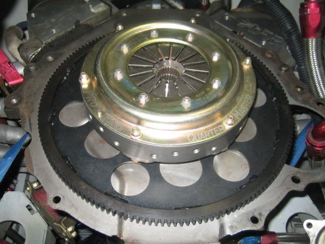

Brian,
I think you made a great choice.
Put a similar set up with the Q-master Extreme V double disc rally clutch set up. Used the original flex plate that came with the GTS and put new discs and a pressure plate on. Also used the Q-master hydraulic throw out bearing / slave cylinder. As you pointed out it's on or off...no in between for engagement. Went to Harbor Freight and bought a 3,000 lb winch with remote for $120.00 for loading. While the motor was being rebuilt I had the trans done as well. Replaced the lower cluster with a newer style 1 piece cluster. Had the inside REM polished and did new synchro's bearings etc.
I'll be at the track (NHMS) Monday to run the car this Monday. I'm really hoping for a good solid day
Hope yours works out well for you. I really believe that your new clutch will perform extremely well.
