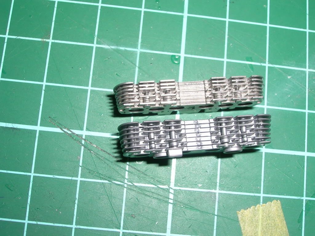

unfortunately when compared to the original plastic part from the kit, The PE assembley is slightly more than 1mm thinner. This is really dissaponting and looks like it needs an extra shim (3 instead of the supplied 2) between each fin.
The only way I can see this happening is to buy a second PE set for the extra shims, but at $50+ that wont be happening. I'm going to contact Hobby Design about this issue and see if they respond.

You have every right to be frustrated and annoyed with Hobby Design but that won't fix the photoetch and neither will they. You might consider pieces of shim brass in between each layer to build it up to proper height.
K&S Engineering sell a pile of assorted sizes of shim stock for about $3.00 (US). Sizes include .001", .002", .003", .005" etc.
Example: (14) x (.003in) x (25.4mm/in) = 1.07mm.
If your hobby dealer doesn't stock K&S you could try a local machine shop. They use shim stock to adjust for wear on their machines.

good point re the height of cylinders as if not right height the assembly will not reach the top hanging points or the rear mounts. good on you for contacting, but how many have ditched a great kit because of omission of parts
