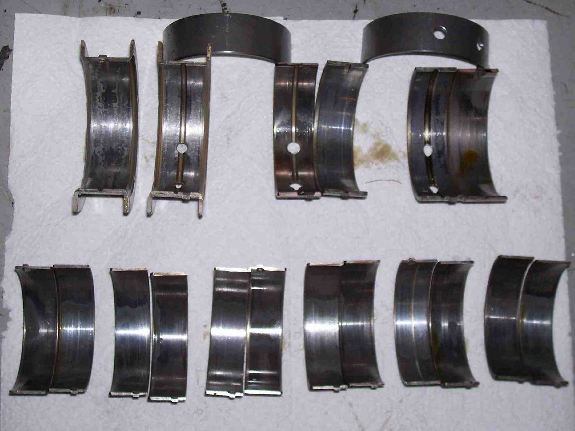

I agree completely. If you see less than 15 at hot idle in DRIVE, stop worrying about the sender and start looking at the pump and bearings - Or both. Been there already, and this had 10 PSI at hot idle on 10W30 Mobil 1:
