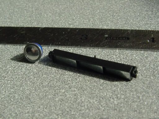

It's a multi-panel rearview mirror made up of usually five staggered and angled rectangular panels to provide a panoramic view. Eliminates most blind spots. They also offer a smaller three panel version which is what I am making for this project... - Mark

Here are two of the three mirrors, the center Wink and passenger side wide angle.

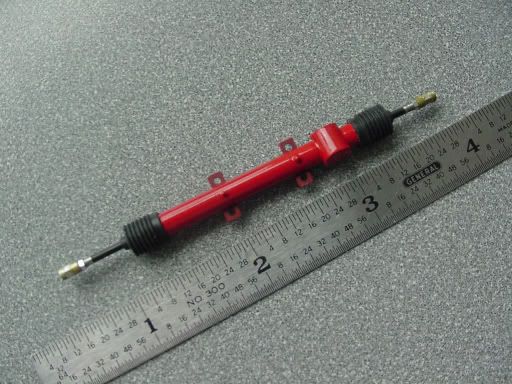

The steering rack. Kept the housing and internal gears from the kit. Replaced the tie rods and made them adjustable. Cut left and right hand threads into them, only the left handed parts are shown here. Yes, the nut was threaded onto the rod. The adjuster is intentionally "marred", ever seen one after it's been wrenched on a few times? - Mark

Impressive job man... I have a question... This is 1/24 parts??

I still belive that ruler got to be one of those large oversized promotional items they hang from the celing in conventions ;-)

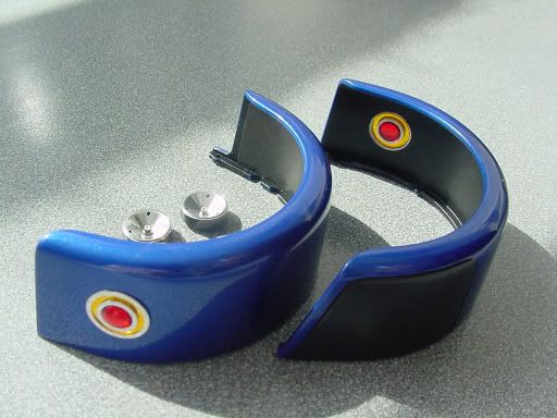

More stuff is coming together...

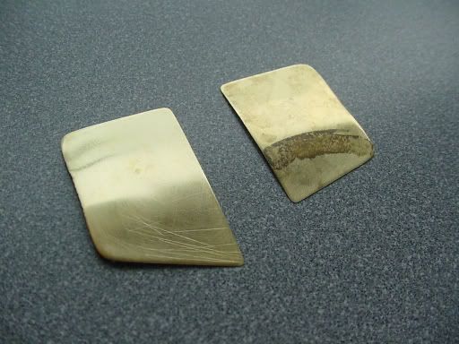

The rear fenders with taillights and C/F stone guards, (made with brass)... Taillight housings and bulbs are shown inside left fender, (not installed)....
