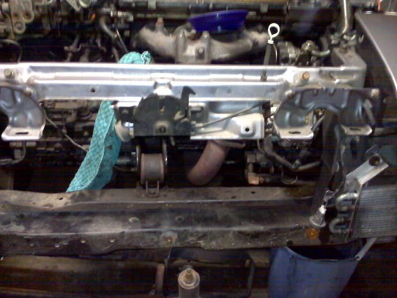

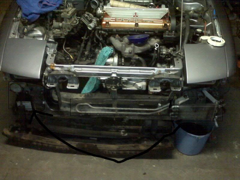

Also a couple more questions. I need to relocate the oil cooler (right box in pic) because where the hot side of the FMIC will run, there's not enough room for the cooler. I'm going to move it to about where the SMIC was at. My question is besides running new oil lines to the passenger side, is it not good to run oil lines that far? I guess what I'm trying to ask is will I have oil pressure issues because of the added distance the oil needs to move? Also I now realize why I was leaking oil in the area around the oil filter and oil cooler, all the clamps were loose enough to spin!!...luckily none of them came off during hard driving!
Also note the power steering coolant lines, in the searches of read they say I need to loop the oil coolant lines because they too are in the way of the FMIC. Do I just cut the line and loop the 2 lines with a rubber hose and clamp them?
Also I'm thinking about not doing the dump tube...thoughts?

Do you have an oil pressure gauge inside the car? I think it would be fine to extend the lines but it would be nice to know the oil pressure just to make sure you have plenty. When I added my entire oil cooler setup I only lost about 8-10psi of oil pressure so I think you will be fine.
Not sure on the PS lines, I have heard of people just looping them but never have dont it myself so Im not real sure on that. Also that dump is pretty close to your oil lines. You should just put a small extension on that pipe. That way you dont have to buy another one

If you saw the papertowel roll guy on the valve cover, I was using that to sketch out the extension but when I was doing it I too noticed that it was way too close to the oil lines. I don't know if I really want to put the dump tube on. I was thinking about running the dump to the lower left side of the down pipe that way it stays clear of the oil lines but if I do that then it puts it more directing towards the oil pan where the oil return from the turbo is at. IDK what I want to do. Is it worth doing the dump tube or not? I want a clean install look but this thing looks hideous. IDK, thinking out loud I guess and I don't have an oil pressure gauge other than the stock one which is pretty hard to figure out if a difference occurs in pressure. I figure that with the move I'll add like 6 or 7 feet to the cooler lines. I might be able to install the cooler in between the FMIC and the radiator but I don't know if it will get enough flow in there. I don't want to screw myself is what I'm basically trying to say.

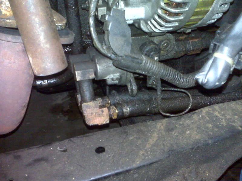

Would anyone be so kind to take a picture of the WBO2 sensor location on your cars? Just trying to get an idea at what I'm going to be doing with it when the time comes.

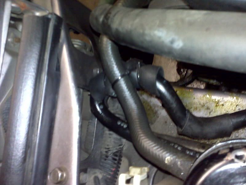

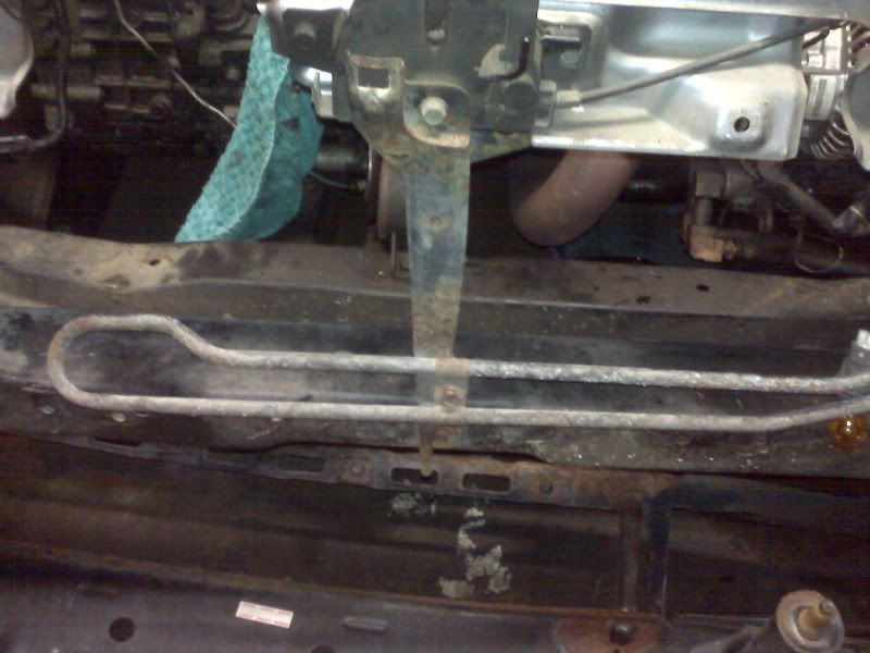

Just got done doing the loopy loop with the PS line, also pulled out the hood release support as directed. I used a piece of the PS cooler as the piece to loop the lines. I also zip-tied the line to another line so it doesn't move around. Couple pics for your enjoyment.

Looks good man, so why did you want to remove the PS?

Thats cool that you got rid of the cooler line. I cant tell what exactly is going on in the picture of how you looped the lines though.

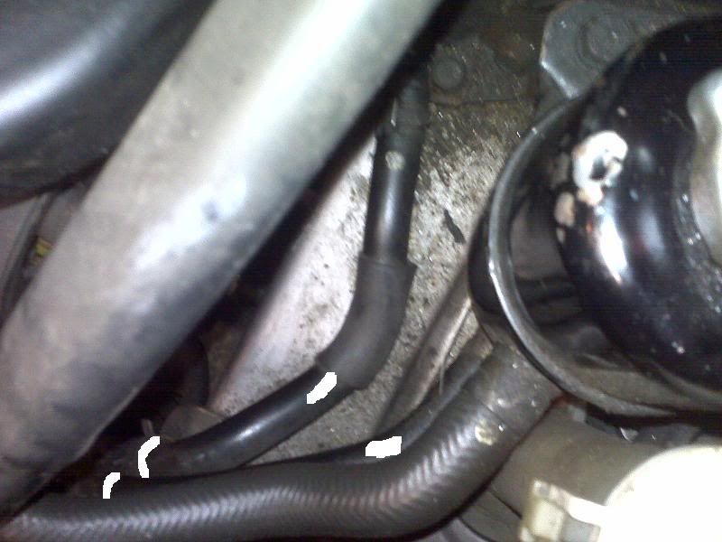

In this picture you can see the 2 lines marked with white spots and also you can see where I removed the clamps from the lines that connected to the cooler.

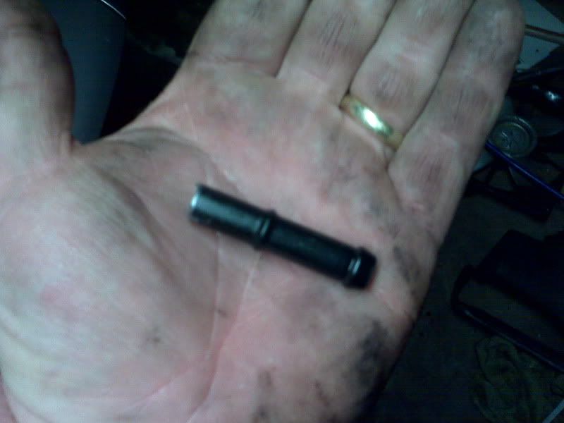

I used this small piece of the cooler to connect the two ends

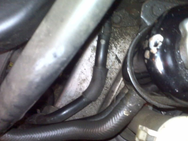

and here it is looped with the cooler removed

I agree with Silver, just add an extension on the WG dump tube. Goto NAPA or something, and pick up some flexible exhaust tubing. Will clamp right on and then you can dump it where ever then.
For the WB, here's where mine is. You can see my narrow and WB both installed facing toward the block. This is from the passengerside. Granted, you have a different motor and setup, but it works the same. I believe you want it no more than 24" away from the turbo, but no less than 6" IIRC. Someone correct me if I'm wrong.
